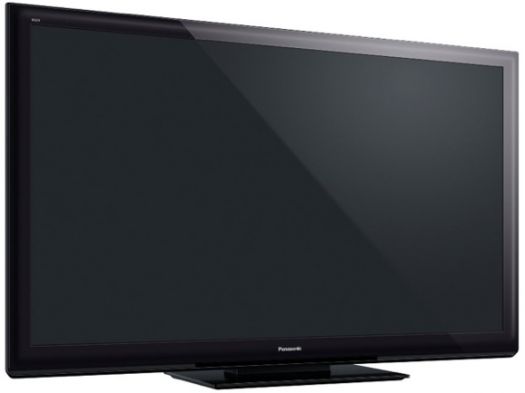

At a newly lowered list price of $1349.98, the TC-P50ST30 may be the entry-level 50″ model in Panasonic’s VIERA 3D HDTV line-up, but its feature-set and picture quality are anything but entry-level: this 2011 model has a lot to offer. Panasonic’s bezel design has never been popular with style-conscious consumers who found it bulky and overly reflective and many of us wondered when they would finally get the message. They got it folks. While not as slim as the bezel on the new VT30 flagship models, the new design looks dramatically thinner and while still reflective, it isn’t that bad. My living room gets a lot of sun in the morning and even more in the afternoon (we had to invest in some pricey shades for the front windows), but the reflections off the bezel were never really a distraction.
One of my biggest complaints about the Panasonic panels has also been addressed; the g-d awful stands that never felt sturdy and always made me wonder when the panel was going to topple over on the floor. The new base is flatter, wider, and significantly more sturdy. If you mount your HDTV on the wall this won’t apply, but for those of us who have media units and little children, it is a cause for concern. The TC-P50ST30 is a large television (30.7″H x 47.4″W x 13.2″D – with stand) and at 66 pounds, heavy enough to do some damage to a curious child, pet or Canadian goose (currently having some issues with a flock who have moved into the neighborhood). So it’s reassuring to know that this set is very stable on top of a console. Of course, we’d recommend securing the panel to your wall via a bracing strap for any permanent or semi-permanent installation.

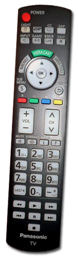

I’ve pretty much given up on remote controls and use my iPad as a universal controller, but I don’t have too many bad things to say about the supplied remote. The backlit design is fairly large and sturdy and it does have all of the relevant controls covered. Panasonic is really pushing the 2D-3D conversion mode and it’s hard to miss the 3D button at the top of the remote. Not a bad remote to say the least.

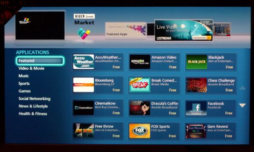

Another major improvement for 2011 is the VIERA Connect interface which is easier to navigate and far more responsive than its 2010 predecessor (the older VIERA Cast version was slow and often crashed in my experience). Things get a bit confusing here because the TV remote button says “VIERA Cast” and this brings you to the traditional VIERA Cast standard on-board apps. But in 2011, Panasonic is branching out into 3rd party app support (including games), so, theoretically at least, more will be coming to this platform as the app catalog grows.
In terms of those on-board VIERA Cast apps, other than VUDU and Hulu Plus, not much is missing here. You’ll find all the usual suspects: Amazon VOD, Netflix, YouTube and Pandora, as well as some extras like Fox Sports and Twitter. Panasonic does need to improve its music apps and Web 2.0 offerings however; Pandora, Twitter, and Shoutcast are really not enough in 2011 when I can get MOG, TuneIn, Slacker, Sticher, and others via my Roku XDS. Perhaps the VIERA Connect app platform will help here? Netflix and Amazon Instant Video are very responsive, but the interface could use a facelift.
