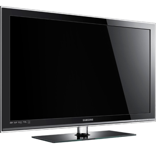

A relatively brief process of natural selection (too small! too big! too klugey! too pricey!) led me toward the Samsung LN40C670 (which, by the way, is the same TV as the LN40C650 except for the touch of color bezel). The LN40C670 is a 40″ LCD HDTV from Samsung’s “6” series for 2010. Unlike the more common LN40C650 which is available virtually everywhere, the 670 is a Best Buy exclusive.
For under $1,000, the Samsung LN40C670 looks on paper like a pretty good set. It has more than enough HDMI inputs, an optical digital output, USB ports for the wireless adapter and flash drives, and a really attractive design. Would the reality live up to the numbers? Time to load up.

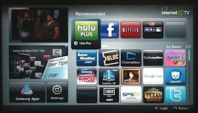

The next thing I did after connecting everything was to plug in the included wireless adapter and try to connect to my home network. Miracles of miracles; it actually worked. Sporadically. As long as I was less than twenty feet from my router which in theory downloads at 20.19 Mps through a hard wired connection to my iMac. The speed test on the televison told a very different story; 4.14 Mps. Not a good start but we’ll deal with how the LN40C670 deals with networking and streaming apps later on.
The LN40C670 connects to its app interface with the push of one button on the remote: “Internet@TV.” I would also give thumbs up to the interface which is very easy to navigate and has a little window so that you can watch the last channel selected in the left corner while you make a selection. The selection of widgets is fairly limited right now, but the selection of film rental services is absolutely stellar: Netflix, VUDU, Blockbuster on Demand, CinemaNow. Seriously, who needs a physical video rental store when you have this level of selection and video quality? The one feature that I didn’t like was that you can’t access the main app menu while using an app; not even if you pause the film. You have to cycle backwards three clicks which was a royal pain in the butt. But if you’re trying to access the settings menu from within an app (like while in a Netflix streaming movie), then here’s a tip: hit the “Tools” button instead of the “Menu” button on your remote, and you’ll get instant access to picture controls and other set-up options.

The bottom line is that LN40C670 offers excellent post-calibration picture quality, anemic sounding speakers, and some of the best media streaming around. The size of the image should not deter you, even if you can swing a slightly larger set, because the overall package is quite persuasive.
