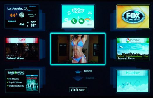

As with most of the TVs that have been into the BPBS labs for review lately, the TC-P50VT25 is so much more than your grandfather’s TV. In addition to built-in NTSC, ATSC and QAM tuners, for tuning in, you know, TV stations, the VT25 also includes a number of apps that transcend the normal viewing experience. Netflix, YouTube, Pandora, Amazon VOD… the choices we have these days for entertainment are dizzying, and Panasonic’s VIERA Cast platform includes most of the major ones (absent are Hulu Plus and VUDU). As long as you have plugged the TV into a home network using an Ethernet cable (or Panasonic’s optional Wi-Fi adapter), you should be good to go for streaming.
If you want to stay connected, without getting off your couch, then check out Twitter which is also available on screen as well as Skype, which turns your huge flat panel TV into an enormous high definition video phone (requires optional Panasonic communication camera). For Twitter, YouTube and other apps that benefit from fast typing, you’ll be happy to hear that the Panasonic VT25 supports connection of a USB keyboard (wired or wireless) to either of its on-board USB ports. Computers? We don’t need no stinking computers!
