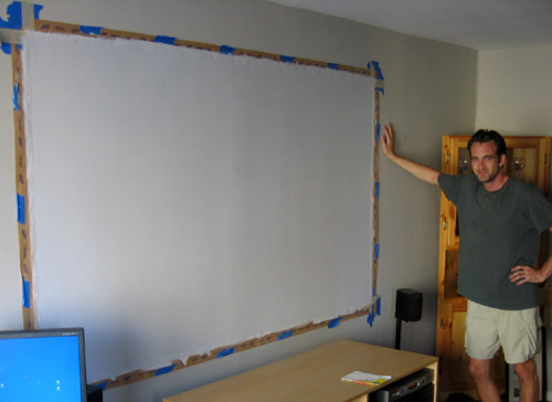

Using an 8-foot length of rigid poplar stock as a straightedge, I connected the corner marks with sweeps of a pencil. I then applied self-adhesive painter’s paper tape outside the screen area, precisely along the pencil lines. This tape adheres best to glossy finishes, so it’s advisable to briskly rub down the area it’ll be applied to with a cloth, slightly polishing the painted surface. Once the tape was on the wall, I burnished it onto the surface with light pressure from a putty knife, to better seal the edge. To prevent the weight of the tape from pulling it from the wall, I applied strips of blue masking tape along the outer edge.
Using a narrow-bladed putty knife, I applied a thin layer of joint compound to the wall, over the inner edge of the paper tape. After this had dried, I used fine grit sandpaper to reveal the edge of the masking. I then used a wide-bladed knife to apply several very thin coats of compound over the entire screen area. After a final sanding with fine-grit paper, the screen was ready for a primer coat. I used an alkyd-based primer because it, when dry, tends to have better sanding qualities than acrylic or latex primers. The primer was allowed to dry and given a light sanding to remove imperfections and fibers left by the roller cover.

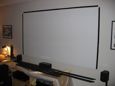

In Frame

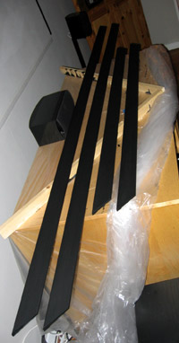

I then cut the framing members from pre-primed baseboard stock. I selected this particular moulding because it was milled with a concave depression on the back that would accommodate the industrial Velcro we were using to attach it to the wall. We chose Velcro because it would allow us to mount the frame to the wall easily and securely without any visible nails. Velcro also allows you to make any adjustments to position so you can get the frame perfectly level and straight along all edges.
I measured the screen for height and width, and those dimensions translated into the inner edge measurements of the frame. Using a simple miter box and finishing saw, I cut the frame members with 45 degree angles at the corners. Once I’d insured that the alignment was true, I primed the moulding with the same alkyd-based primer I had used on the wall, applied with a roller and smoothed with a nylon brush. After drying, each piece was rubbed down with fine steel wool to remove imperfections and roller cover fibers. Next, I applied a coat of matte black, alkyd-based paint and allowed it to dry. I then trimmed and applied the hooked Velcro backing to the back of each frame piece, pressing down into the concave trough, and burnishing it with a round-edged tool to secure the adhesive backing.
After gently sanding the moulding pieces with fine sandpaper (taking care not to expose the factory-applied white primer), I cleaned the frame pieces for their final paint job. I used matte black spray paint shot from a can. The first coat was applied in an even manner, spraying past each corner to avoid heavy buildup of the pigment. After drying, successive, light coats were misted on until the surface was a rich, velvety black without any sheen. At this point each piece was handled with latex gloves to reduce fingerprints and set aside to cure fully. While the framing was drying, I applied the woolly Velcro strips to the wall, using the hard edges of the screen as a guide.

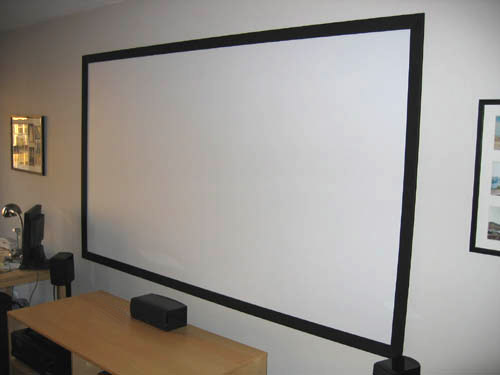

After 24 hours, the framing was fully dried and ready for hanging. The uppermost piece was affixed first, pressing firmly along its length to ensure that the Velcro gripped evenly. The side frames were attached next and the lower piece last. I then turned on the projector and made some minor adjustments to the framing. Again, latex gloves were worn throughout to protect the powdery surface of the frame.
Jaw Drop? Check!

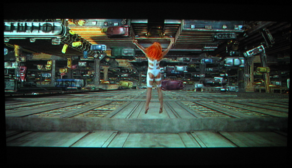

How did it all turn out, then? The Screen Goo system produced an image that was vastly superior to that cast on the old grey wall: greatly more luminous and detailed, with wonderful contrast and deep blacks. Color fidelity was sensational. The screen performs so well that it will reveal any limitations in the image being projected upon it: DVD’s that had formerly seemed acceptable stood revealed as the terrible transfers they really were. The black frame did a great job of lending contrast and effectively neutralized spillover caused by the warped wall. As an element of the room it occupies, the screen is quite unobtrusive, thanks to the undecorated framing and shallow profile. Because of its somewhat tricky handling properties, I would recommend that Screen Goo be applied by someone well-versed in paint application techniques.
A recent visit to a local art museum gave me an opportunity to see a video-gallery coated with Screen Goo. Those surfaces appeared to have been sprayed, but performed no better than our austere screen painted with a roller. In my opinion, Screen Goo produces a greatly superior image that is more than worth the price, and will significantly upgrade the performance of your projector-equipped home theater at a fraction of the cost of a factory-built screen. Thanks to Screen Goo for developing such a terrific product.
