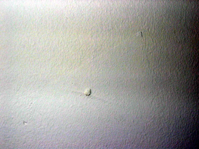

The final drawback to simply pointing your projector at your current wall is that many walls do not have perfectly flat surfaces. Whether we’re talking about textured plaster walls that were never meant to be flat or the little bits of damage like nail holes and cracks that can accumulate over time, flaws in the wall’s uniformity can create serious defects in the viewable image.

Goo Systems – a Canadian paint manufacturer – has spent years of research and development perfecting paints for use in projection screens. Having seen ScreenGoo on display at shows like the New York Home Entertainment Show, the Big Picture Big Sound staff was eager to try it in an actual home theater. The lucky winner was resident film guru and co-founder, Joe Lozito. Joe’s Sanyo PLV-Z2 LCD projector (3 chip LCD, 720p resolution, 16:9 aspect ratio) was previously being used to decent effect to project large images onto Joe’s Manhattan apartment’s bare walls. But the off-white marginally reflective latex paint, combined with a noticeable crack running the full height of the “screen” made the viewing experience far from perfect.
