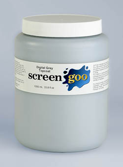

Goo Systems, a paint manufacturer based in Canada, has designed a special highly reflective acrylic paint called Screen Goo, formulated specifically for use in front projection installations. Years of research and development have gone into the formula to get the best results while maintaining a fairly simple application process. The process involves applying both a base coat and a top coat, with the specific paint formula matched to the desired screen size, ambient lighting conditions and most importantly, the technology of the projector. Screen Goo colors include “CRT White,” “Digital Gray,” “Digital Grey Lite,” and “Ultra Grey.” The Goo Systems web site features a product selector which is extremely useful in helping you make the right color choice for your specific projector as well as calculating how much Goo you’ll need for the job.
For our purposes (Sanyo PLV-Z2 LCD projector with a 98 inch diagonal screen length and subdued lighting), the recommendation at the time was one liter each of Digital Grey base coat and top coat at a cost of around $170 US including shipping. Using light grey, as opposed to white, compensates for most digital projectors’ inability to produce true black. Don’t worry, “Digital Grey” looks perfectly white when actually viewing content on the screen. The gain of the Digital Grey coating is a maximum of 1.2 directly on axis, tapering off to around 0.8 forty-five degrees off axis. Goo has recently introduced “Digital Grey Lite” which provides a gain of up to 1.4 on axis, in case you need a larger screen, or you’re dealing with higher ambient light.

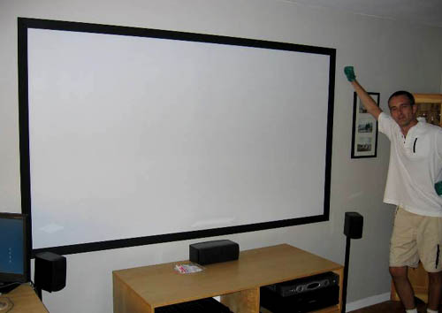

In addition to the Screen Goo itself, we needed rollers, spackling compound and masking tape, plus wood moulding, industrial Velcro and flat black paint for the home-made frame. This added approximately $75 for a total of just under $250 for supplies for the project.
Once everything arrived, our resident paint-meister Adam Clem prepared the wall, filling in cracks and smoothing out defects, applied the base coat, then the top coat via rollers, then assembled, painted and mounted the black wood frame. The full construction process is revealed in our companion article “How To Paint your own Projection Screen.” Once the Goo had dried, we calibrated the picture using the “Avia Guide to Home Theater” DVD, then sat down for some serious watching. The results were not subtle.
On any program material, including High Definition documentaries and nature shows on Discovery HD and PBS-HD, and DVD movies like “Gladiator,” “The Fifth Element” and “The Lord of the Rings” (all three parts), the picture, which had been pretty good even on the old wall, assumed a new level of realism and accuracy that greatly enhanced our enjoyment.
“It’s like, how much more black could this be? and the answer is none. None more black.” – Nigel Tufnel, “Spinal Tap”
Blacks which had been medium to dark grey were now much closer to real black. Reds and greens which had been slightly washed out became more vivid and the contrast between light and dark parts of the image became much more pronounced. There were no visible hotspots and walking from side to side, even to 60 degrees off-axis, exhibited a very subtle degradation of overall brightness.
