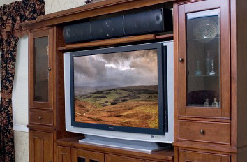

Atlantic Technology’s FS-5000 (for “Front Stage”) has taken design cues from the one-box surround bars mounting the left, center and right channels within a single low profile box but they leave the surround duty to separate rear or side speakers. From a design perspective this is great because now I have a choice of mounting the FS-5000 on the wall directly below the display, or in the cabinet that houses the rest of the equipment – the same choices I would have with a standard center channel speaker. There is no need to consider the placement and mounting of the left and right channels and no need for stands or floor space for tower speakers.
Because the FS-5000 was designed for stereo music listening as well, the tweeters have been placed in a mirror fashion at the extreme outside edges of the speaker bar. This placement enhances imaging and soundstage width. But that’s not the end of Atlantic’s attention to detail. As per the documentation, “In the FS-5000, each speaker utilizes two high-power 4 ????-inch GLH woofers and the 1-inch (25mm) soft-dome tweeter. The drivers are mounted in an acoustically inert, heavily braced MDF enclosure and are magnetically shielded so they may be placed close to any type of video monitor without concern of video interference. Note also that the tweeters are mounted above the centerline of the woofers. This arrangement results in a smoother in-room frequency response, for greater clarity and detail.” In other words, the Atlantic Technology guys are smart, so you don’t have to be.

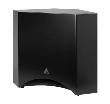

A very interesting approach that Atlantic Technology has taken is to take a 10-inch subwoofer and design it to fit in a corner. Loading the sub with a corner placement gives it the ability to impersonate a 12-inch subwoofer with ease. My own sub, the Paradigm PW2200 (of the 12-inch persuasion) had nothing on the 10e CSB. Sure it could move more air (there still is no replacement for displacement), but it was not noticeably louder, and in no way was it quicker than the smaller, lighter and less obtrusive 10e CSB. This is one nice sub.
Atlantic Technology has chosen to go back to basics in the design of the 10e subwoofer, using an acoustic suspension (sealed) design. This design, although less efficient in terms of maximum SPL, is quicker and punchier than its ported counterparts. I noticed this right away after switching from my Paradigm, thinking that something was missing. It seemed as if this sub wasn’t doing the job, but after a few days of break-in and some time for my hearing to readjust, what was “missing” was actually two things: the thud in my chest, and the boominess that went along with it. For years now a good friend of mine in the HiFi business has been trying to convince me to get rid of my big sub in favor of a less colored smaller sub. I guess I’ll have to give him a call to tell him he was right. Hmmm… I wonder what a pair of these would sound like?

The FS-5000 LCR speaker bar was made specifically to match the look and size of a flat panel television. Dimensions of the FS-5000 match nicely with the width of a 50-inch display. If you have a 42-inch display, Atlantic Technology makes a FS-4000 model which is sized accordingly.
Set up and installation of the system was remarkably simple. Atlantic Technology included everything in the box. For the FS-5000, this meant a keyhole slot on the rear for mounting on the wall, straight and angled brackets for wallboard mounting with a plug and screw, a special mounting plate if stud placement didn’t work with the location of the display and a two piece adjustable plinth for mounting on top of a cabinet. The 2200 SR rears came with keyhole slots a ????-20 screw hole for using standard adjustable wall mounts. The 10e CSB even came with two sets of feet, rubber and spikes. The spikes even came with custom metal blocks to protect delicate flooring from scratches (and still benefit from the isolation afforded by spiking).
The FS-5000 has switches located on the back which allow individual control of each speaker’s response. These allow you to optimize the speakers for placement (wall-mount or free-standing in a cabinet) and for the specific acoustics of your room. The 2200 SR has a switch located on the rear for switching between bipole and dipole modes.
In dipole mode the 2200 SR’s produce an ambient and diffused sound field with minimal localization (which I liked best for most movies and video soundtracks). In bipole mode, soundstage precision was enhanced – you can hear exactly where different sounds originate (better suited for multi-channel music playback). Switching between dipole and bipole mode is easily accomplished using a toggle switch conveniently located in the speakers’ rear terminal cup so you can listen back and forth and decide which option works best for your specific tastes.
The setup of the 10e CSB was typical for a sub. Adjustments are available for phase, cross-over and volume. Because placement in a corner has been predetermined by design, the trial and error of placement to eliminate boom or other nuisances has been minimized. It’s still worth experimenting with placement however: moving a subwoofer a few inches left or right can make the difference between bass nulls or boom and can greatly influence your overall enjoyment of movies and music. Check our tutorial on subwoofer setup for more details.

I wanted to see what the FS-5000 would sound like if it had some help down low, so I connected the 10e CSB to one of the main channel outputs on the back of the receiver. What a difference! The reproduction definitely benefited from the addition of the bottom few octaves, and those octaves and the music were dramatically enhanced by the speed and precision of the sealed 10e CSB.
