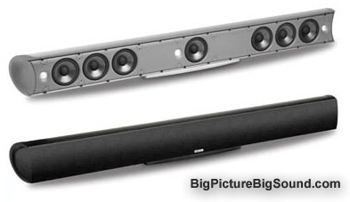

Some of us are lucky. We have indulgent spouses who allow us to plaster the walls with speakers in pursuit of the ultimate multi-channel surround sound system. But for many folks, this just isn’t an option. Whether it’s a media room with floor to ceiling windows as a rear wall, a rental apartment where fishing wires through walls isn’t an option, or simply a décor mandate that decrees “no rear speakers,” there are times when placement of rear speakers in a home theater system just won’t cut it. But what’s a poor movie lover to do? Suffer through with just two or three front speakers or – gasp! – get by with your television’s built-in speakers? Heavens, no! What you need is a cleverly designed system that employs advanced technology to create the illusion of rear channel speakers without any actual rear speakers: enter Polk Audio’s SurroundBar.â„¢
For those unfamiliar with the brand, Polk Audio has been manufacturing mid to high-end loudspeakers for the home and car since 1972. In the late 70s, they pioneered the “Stereo Dimensional Array” (SDA) concept, which used specially designed phase cancellation technology to widen the soundstage from a pair of stereo loudspeakers and to maintain a stable stereo image from practically anywhere in the room, not just the “sweet spot.” Polk has now expanded on this SDA technology to create SDA Surround – a passive one-box speaker system designed to create the illusion of width, depth and even rear surround sound from a single low-profile cabinet, placed at the front of the room.
How do they do it? Well getting into all the details would probably make your eyes glaze over (it did mine), but two things primarily come into play – targeted phase cancellation widens the soundstage (so the front left and right speakers sound further apart than they really are), and “Head Related Transfer Functions” (HRTFs) are used to make rear channel sounds seem as if they are coming from behind you.
The theory behind HRTF is that our brain determines front to back direction of sound based on tiny differences in the time it takes these sound to reach our ears, combined with the way our ear shape and orientation affects the frequency response of incoming sounds. If you delay a sound just the right amount, and adjust its frequency blend so it matches the way it sounds when it originates behind your head, then you can theoretically simulate rear-channel sound from a speaker that’s actually in front of you. So does it work? Yes… and no.

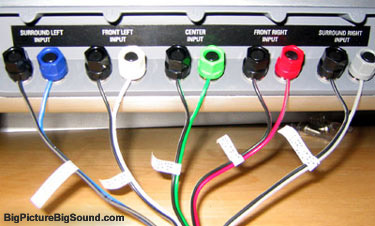

Setting up the SurroundBar was simple – use the included 25 foot color-coded cable (or your own cables) to connect the five speaker outputs from your receiver (left, right, center, left surround, right surround) to the corresponding inputs on the Surround Bar, place it on its included stand in front of your TV, connect a subwoofer to your receiver’s subwoofer out, and adjust the levels.

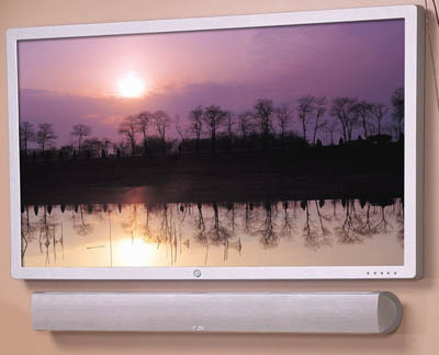

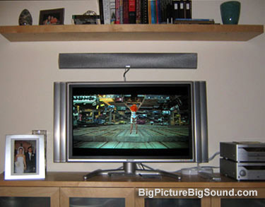

The SurroundBar comes with a wall bracket and table stand, so if your television is sitting on a stand or entertainment center, and there’s room in front, then placing the SurroundBar immediately below the TV is your best bet. If you have a flat panel TV mounted on the wall (or a front projection system projecting on a wall or screen) then you can mount the SurroundBar above or below the screen, but with experimentation, I found placement below the screen to sound better than above. The closer you can get to ear level, the better.

One thing I do recommend highly is to follow the set-up advice that comes with the SurroundBar, in terms of setting the rear channel levels. Do not bother using a receiver’s auto-calibration features (assuming yours has one), as these systems are not really compatible with one-box surround speakers. Calibrate the levels instead with a Radio Shack SPL meter. And once the levels are “right” (equal SPL readings from each channel), then crank up the rear channels an additional few decibels higher. In my final settings, on an Onkyo home theater receiver, I ended up with the front channels set at 0 and the rear channels at +6 in order to get the best effect. In the end, listen to material with which you’re familiar, and set the levels however they sound best to you.
