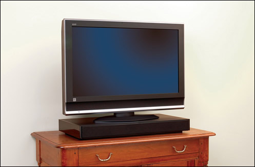

Previous ZVOX designs have enjoyed pretty much unanimous positive reviews, but placement of the diminutive yet still substantial speaker module can present a challenge for some. The new Z-Base 550 answers the question “Where the hell do I put that sound bar when my television sits on an equipment rack or inside custom cabinetry?” At just 28″ wide, 14.5″ deep, and 3.5″ high, the Z-Base 550 can sit happily beneath the pedestal base included with most flat panel televisions, only raising the set a few inches above its current height on an equipment rack or cabinet.
As long as your TV’s built-in pedestal stand or attached feet measure in at 27″ wide by 13″ deep or less and the TV’s total weight is no more than 90 pounds, then you’re in business. My 46-inch Panasonic plasma was at the high end of the weight limit, but posed no problems for the 550. Most 52-inch and below LCD and plasma flat panels should be supported but check your specs (and measure your base) to make sure.

The twenty pound cabinet houses five 2″ front-firing speaker drivers (three mono center channel drivers, one left and one right channel drivers), a 5.25″ down firing, rear ported subwoofer, and a sixty watt amplifier. The 550 comes with a small external power supply, a two meter RCA-RCA interconnect, and a credit card sized remote control. In an effort to keep the front panel clean, there is no display other than a small blue light which serves to indicate that the unit is powered on and flashes to indicate remote control directives. The rear panel includes a main power switch, two mixing analog inputs and an external subwoofer hook-up for those who want even more bass.
The 550 employs two design concepts which function to help the cabinet disappear and create an open sound with a wide soundstage. First, the ZVOX Infinite Compliance system connects the left and right channel front speakers with an acoustical tube which ZVOX claims creates a “bigger” sound. Second, their Phase Cue system mixes various levels of in phase and out of phase signal into their left and right channel drivers which creates a wider sound stage. The Phase Cue system is user adjustable with nine levels of adjustment. ZVOX recommends lower settings for listening to music and higher settings for watching television/film.
Fit and finish are quite nice for a unit at this price point. The side panels have a hand lacquered, high gloss black finish. The top of the unit is a more rugged matte black vinyl to handle the panel’s platform with resistance to scratching. The face is a well fit, handsome metal grill. A nice surprise, but not on display, is a brushed metal rear plate (is that the opposite of face plate?) which houses the few input/output jacks.
