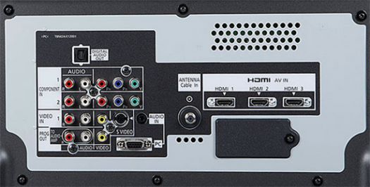

In addition to the picture enhancement features discussed above, the unit includes a pretty robust set of usability features, including 4 HDMI inputs, an SD/SDHC card slot for viewing pictures directly on the TV and VieraLink, an extension of HDMI-CEC that allows you to operate multiple Panasonic products from one remote, even if those components are not accessible via line of sight. In other words, you can hook up a Panasonic DVD or Blu-ray Disc player to the PZ800 and control its essential operations from the TV remote, even if the disc player is hidden in a cabinet or equipment closet. To take advantage of this, simply hook up the device via HDMI and enable VieraLink on both components.
The PZ800 also includes a built-in NTSC/ATSC/QAM tuner for tuning in analog and digital broadcasts from cable or over the air. I connected the set to a roof antenna and had no trouble acquiring the 30 or so local channels and sub-channels being broadcast over the air from the Empire State Building. The quality of signal the internal tuner was excellent and the Info button on the remote showed program details of the current channel and show.
Occasionally, I noticed a slight picture glitch at the very top of the set when watching internally tuned channels (or the output of a cable or satellite receiver connected via HDMI). This is caused by incorrect overscan by the broadcaster. Fortunately the Panasonic TV allows you to correct for this in the Picture settings menu under “advanced picture” controls. I adjusted the “HD Size” setting to zoom the image slightly which cropped out the overscan distortion.
The set also includes a VGA (DB15) input with a mini-jack stereo audio connection for computer hook-up. Unfortunately, like many PC-enabled TVs, the input resolution from the analog VGA port is capped at 1366×768 and below. But the set does a good job scaling PC output resolutions to the set’s native 1920×1080 panel resolution. If you want to hook up a PC at native 1920×1080 resolution, your PC will need a DVI-D or HDMI connector which you can connect to one of the set’s HDMI inputs. If you are using an HDMI connection from PC to TV, then you can enable the TV’s analog audio input on one of the 4 HDMI inputs so you will get PC sound through the TV speakers as well.

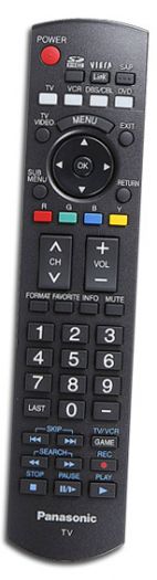

The remote control is a basic non-backlit unit with some transport controls for operating a VCR, cable box, DVD or Blu-ray Disc player. Although it lacks direct input buttons for each of the 10 inputs, it does not require that you scroll through all of the inputs to get to the one you want. Instead you can hit the “TV/Video” button then the numeric input corresponding to the input you want. For example, hitting “TV/Video” then “4” will select the HDMI 1 input (the fourth input on the list). This makes programming a universal remote to operate the TV a little simpler and more fool-proof.
