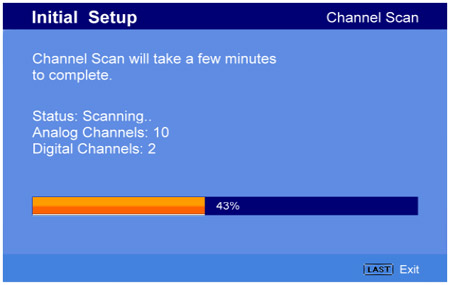

Once you’ve selected and installed your antenna, the last step is to get into the set-up menu of your HDTV or digital converter box and let it run through the “auto add” or “channel scan” feature. You will generally find this option in the Set-Up menu, under “tuner settings,” “initial set-up” or something similar. Make sure to select “antenna” or “over the air” instead of “cable” as your input type. This channel scan feature may take a few minutes as the tuner searches all of the available frequencies and locks in those channels that are strong enough to tune in.

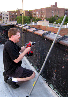

On a couple of recent “service calls” to friends houses in Queens, I was able to set up one friend with all of the local channels (including WNET) with a simple indoor Picture Frame antenna made by Antennas Direct. And I helped another friend get everything but PBS with a medium range outdoor directional UHF/VHF antenna (also by Antennas Direct).
We installed this antenna on the roof of their coop building which offered a direct line of sight to the broadcast antennas currently located on the Empire State Building, approximately 3 miles away. Because of the multi-path distortion so common in large cities (due to signal reflections from multiple buildings), we needed to insert an inexpensive variable attenuator into the line to clean up the ABC and Ion feeds. But overall, it was a pretty painless exercise with immediate and stunning picture quality results.
On our own roof (also in Queens), I used the new Clearstream2 (C2) antenna from Antennas Direct. It’s optimized for upper VHF and UHF signals, which is all you’ll need to receive digital channels before and after the digital transition. This produced the best results overall with all 24 channels rock solid at 75% to 100% signal strength.
