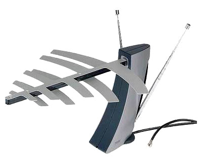

Terk HDTVi UHF/VHF/HDTV antenna.

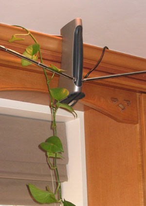

It didn't take long to find a good spot for the antenna, for both reception and aesthetic purposes, and I admit it is probably not the most traditional placement. Our antenna is currently hanging by its UHF elements from the top of our kitchen cabinets with the rabbit ears spread out horizontally. It may sound odd, but when my mother came for a visit, she was there three days without noticing it was there. This means the UHF elements actually have a brick wall between them and the broadcast tower, but we are very close to the broadcast antenna (less than a mile) so this barrier was not enough to impede a strong UHF signal.
Without amplification, the signal from the HDTVi was able to provide glitch-free reception of all of our local digital and analog channels to any one device (HD DVR, DVD recorder, VCR, etc.) but the signal was not strong enough to be split among multiple devices. However, I was able to amplify and split the signal eight ways using a Channel Master amplifier/splitter and the quality of digital channel reception was not significantly worse. So, even split 8 ways (with a decent amplifier), I was able to get a strong enough digital signal to receive all of the local HD and SD digital channels. analog VHF reception did lose a bit of quality when split this many times, but this is to be expected from such a simple antenna that is not ideally placed.
Most outdoor antennas have multiple crossbars or elements (for both UHF and VHF reception). The lengths and orientation of these elements are actually critical in getting the best reception. The UHF portion of the HDTVi follows this design, with multiple horizontal elements of varying lengths. This allows the antenna to do particularly well receiving UHF/HDTV signals. But the VHF rabbit ears are effectively one single element so no matter what you do, some VHF channels will come in better than others, depending on antenna orientation and the length to which you extended the elements. For the best overall reception, I ended up with the VHF antenna extended about two thirds of the way with the elements angled just slightly toward the transmission towers. This gave me the best overall reception for VHF, and, as mentioned above, digital reception was just peachy.
