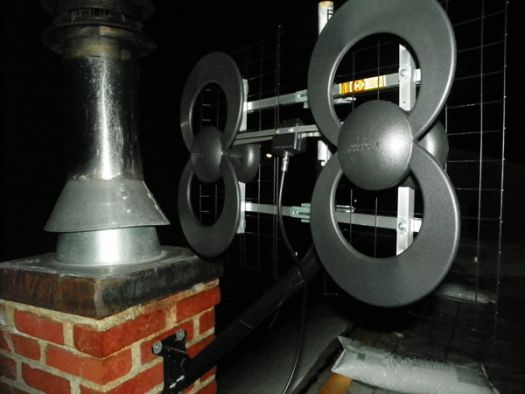

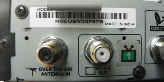

Fortunately, many satellite DVRs have an option to tune into local channels directly, via standard OTA (over the air) broadcasts and an ATSC tuner. For my DVR, a DISH ViP722k, I needed to contact DISH to get the ATSC tuner module (a $50 one-time fee for purchase). This little card slides into the back of the DVR, and has a coax jack to attach an antenna. Once it’s attached, and you plug in an antenna, you’ll be ready to rock. Since I’m about 30 miles from my local TV broadcast towers, I opted to use an outdoor (rooftop) antenna, Antennas Direct’s ClearStream4.

Some antennas actually come with all of the mounting hardware you will need for the installation, but many do not. Also, a few extras never hurt. Since I was mounting the antenna on my rooftop, I opted for a J-mount antenna mast, which hoisted the antenna up an additional 30 inches.
Also, I opted to run a direct line from the antenna to my ViP722k box. For me, this was the best solution as I didn’t want the antenna near my existing satellite dishes, which are on the side of my house. My best OTA reception seemed to be coming from the roof, so I ran a line from there into the side of my house, near where my satellite cable enters. Of course, this requires a bit of cable splicing and termination, as well as drilling into the side of the house. There’s nothing like the feeling of drilling a big hole in your house (my husband helped with that part and you should have seen the grin on his face). Of course, if you’re renting, we’d recommend getting your landlord’s permission first. Another option is to use a flat coax coupler. It’s thin enough to squeeze over the top or bottom of a window while the window itself remains closed.

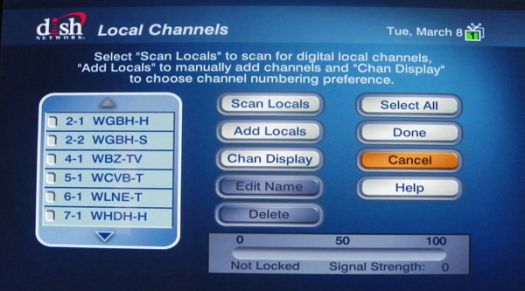

First, you need to enable your your local channels on your receiver, which isn’t half as difficult as installing the antenna. On the ViP722k, I clicked the DVR’s menu button, went into System Setup (option 6), and then Local Channels (option 9). From there, choose “Scan Locals.” It just takes a minute for the receiver to scan through local digital channels. At the end, click OK.
This takes you back the Local Channel menu screen (see above photo), where you can choose to only add specific channels or just add all of the digital channels found during the scanning process. Don’t want to add the same channels that you receive through satellite? It’s easy to clip them out. However, I found at least a handful of digital channels broadcasting in HD, that were not being offered by my DISH Network service.
