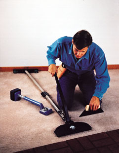

Hopefully your carpet isn’t laid yet, or you were planning to get new carpet anyway. If that’s the case, you can work with the carpet installers to be sure they don’t damage the wires with their installation tools. If your carpet is already installed, then you have a little more work to do.
Some carpets are glued to the floor. If so, scratch this option off your list. Other carpets are mounted to the floor using tackless strips. These are thin, inch-wide wooden strips studded with tiny spikes. The installers nail these strips spike-side-up along the outer perimeter of the room (even on cement). Then they stretch the carpet and tack it onto the strips.
If you’re brave (and careful! wear heavy work gloves for this), you can gently pull the carpet from the strips and roll it and any padding back. Lay down your cable, then put the carpet and padding back in place. Pull the carpet as tightly as you can toward the wall and stick it back onto the strip. This isn’t my first choice because the carpet may wrinkle and buckle in certain spots. Installers use a carpet stretcher (not a knee kicker) for just this reason.
