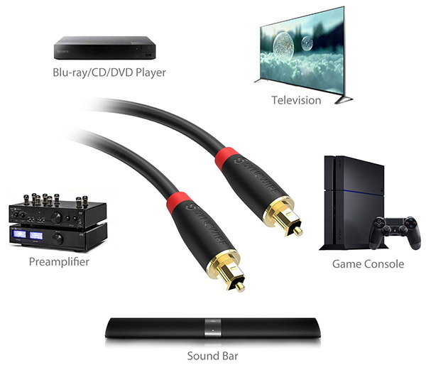

While your LG TV doesn’t have a set of analog RCA audio outputs, it actually does have two audio outputs that you can use to connect it to a home theater system, soundbar or audio receiver. It has a fiberoptic (TOSLINK) digital output. This would use a standard fiberoptic cable, but only if your home theater system has an available fiberoptic input. The same cable would work with most soundbars.
Your HDTV also has a headphone output, which you can connect to stereo RCA inputs using a simple stereo 1/8″ to RCA adapter cable.
Here are a couple of choices:
- 1/8″ (3.5 mm) headphone plug to stereo RCA plugs (analog) – 5 feet long
- fiberoptic cable (digital) – 6 feet long
You could plug either of these cables (analog or digital) into your home theater system, depending on the inputs available on your receiver. The fiberoptic digital connection is preferred as it will allow you to get Dolby Digital 5.1 surround sound from broadcasts that include it.
