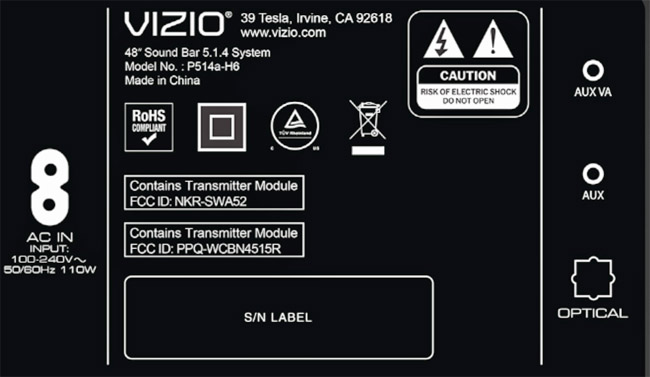

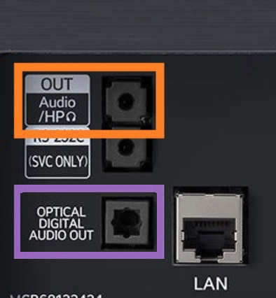

Just about every TV made has some sort of audio output on it. The most common, particularly on TVs that are a few years old, are fiberoptic digital audio (a squareish connector that glows red when the TV is on) and analog audio (usually in the shape of a 3.5mm headphone jack). Of the two options, it’s preferable to use the fiberoptic digital connection as that will allow you to pass multi-channel surround sound audio from your TV to your receiver or soundbar. But if you only have an analog headphone jack, you can use an analog cable to get sound to your soundbar or receiver.
For fiberoptic digital connections, you’ll need a fiberoptic digital audio cable (also called “Toslink”). If you use the analog audio output or headphone jack, you’ll probably need a cable that has a 3.5mm (1/8-inch) headphone style plug on one end and a dual RCA plugs on the other end. In some cases, a soundbar may include a 3.5mm (headphone jack) analog input instead of RCA. This may be labeled “analog audio” or “AUX” (for “auxiliary” input). This cable looks like a headphone cord, but with the same male 3.5mm plug on both ends. Check your specific soundbar or speaker to see what type of analog input it offers. Here are a few cables that will work for most gear:
- Fiberoptic digital audio cable (6 feet)
- Headphone plug (3.5mm) to dual RCA analog audio cable (8 feet)
- Headphone plug (3.5mm) to headphone plug analog cable (6 feet)

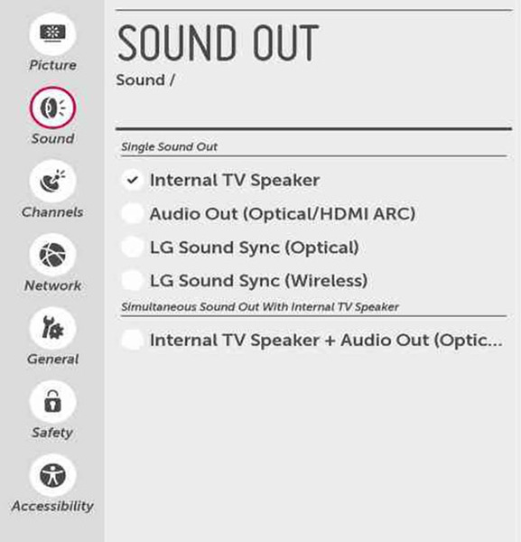

Once you’ve connected the right cable between your TV and audio system, you may need to activate that audio output. Check in your TV’s setup menu for an “Audio Settings” or “Sound” sub-menu. This will usually have an option for where to send the sound, with choices such as “TV Speakers” or “Digital output” or “Headphone out.”
Select the appropriate choice based on which type of output you want to use. In most cases, when you use the digital output, the TV speakers will be turned off and your TV volume control won’t work any more. This is normal. Just adjust the volume using the receiver or soundbar’s remote. Some soundbars actually let you program the bar using your TV or cable box remote. This will allow you to keep using your TV or cable remote to adjust the sound level of the external speakers.

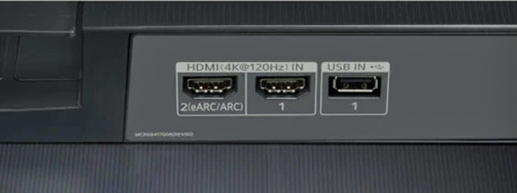

More recently, some TVs have chosen to omit both fiberoptic and analog audio outputs from their TVs, but there still may be a way to get sound from your TV to the home theater system. And it’s actually a better quality option than fiberoptic or analog audio. TV makers have found a way to turn an *input* into an *output.* It’s something that happens on one of the TV’s HDMI ports and it’s called ARC (Audio Return Channel) or eARC (enhanced Audio Return Channel). With this type of HDMI port, the same HDMI cable that you use to connect your receiver or soundbar to the TV to send video signals to the TV also carries the sound back from the TV to the receiver or soundbar. It’s a pretty neat solution, but it’s not always simple to use.

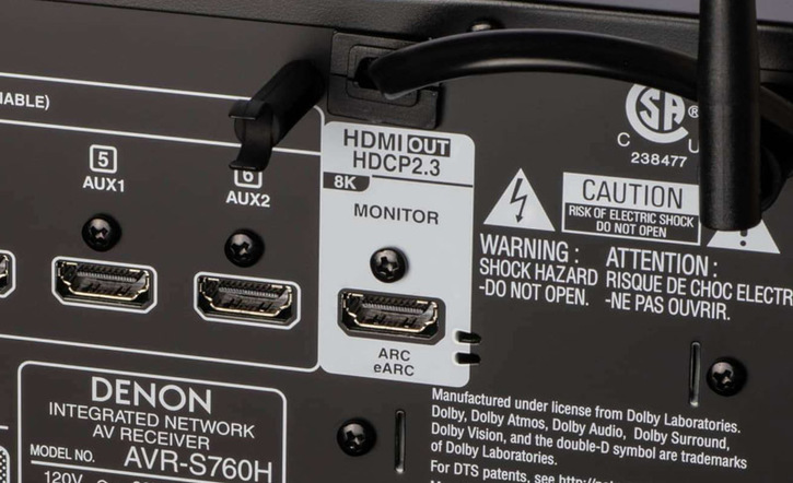

The first step in using ARC or eARC is to look on the back of your TV for an HDMI port that says “ARC” or “eARC” on it. eARC is the better option as it can transmit higher quality audio than ARC. If your TV has ARC or eARC, you’re in business. If not, you still have options (keep reading). If you do have a TV with ARC or eARC support, then check your receiver or soundbar to see if it also has an HDMI port with ARC or eARC support. For ARC or eARC to work properly, both the TV and the receiver or sound bar need to support the ARC or eARC feature.
To use eARC or ARC, connect the HDMI ports labeled ARC or eARC on both devices to each other using an HDMI cable. You’ll need a high quality/high speed HDMI cable with ethernet capabilities. Sometimes issues with getting ARC or eARC to work are resolved simply by buying a better HDMI cable. Here’s an affordable HDMI cable that works with HDTVs and 4K TVs with ARC or eARC:

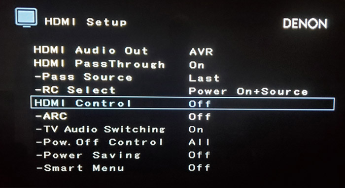

ARC and eARC are useful in connecting a TV to an external audio device, but getting the feature to work is far from “plug and play.” In most cases, you will need to access both your TV’s and your receiver’s settings menus to enable the feature. On the receiver, first look for a feature called “HDMI CEC” (Consumer Electronics Control). HDMI-CEC allows you to operate multiple devices, like a set top box, Blu-ray player and TV, all with one remote control. On most TVs and receivers, you need to first turn on the HDMI-CEC feature in order to enable the ARC feature. The newer version of ARC (eARC) can work even without HDMI-CEC being enabled, but it’s a good idea to make sure HDMI-CEC is enabled anyway. You can always turn it off later if you find it is not needed.
Make sure HDMI-CEC is turned “ON” in your receiver or soundbar and on your TV. Also on the receiver and TV, make sure ARC or eARC are set to “ON” as well. These are usually two different settings in different parts of the set-up menu. In some cases, you also need to access your TV’s “audio settings” menu to disable the TV speakers and enable the external device (receiver or soundbar) to provide the sound. In many cases, you will select the “TV” input on your receiver to get sound from the TV over ARC. But there are exceptions. Many Yamaha receivers, for example, use the “Audio 1” input for ARC sound. Some receivers allow you to assign the ARC audio input to a different named input if you prefer.

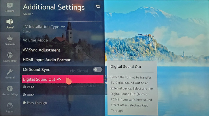

The same rules apply for ARC apply for these devices: make sure the TV’s HDMI-CEC and ARC features are turned on. Also, in some cases, you’ll need to make sure your TV’s digital audio output is set to “PCM” (not bitstream). You can usually find this in your TV’s audio setting menu. You can read more about using your TV’s HDMI/ARC output to feed sound to a receiver or soundbar with no HDMI inputs in this article:
