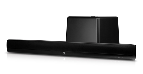

I just recently got a Samsung LED TV. It looks great but sounds terrible. So I picked up a sound bar. It’s a Boston Acoustics TeeVee 26 and came with a subwoofer too. So what’s the best way to connect the sound bar up to the TV and the sub? I want to get the best sound.

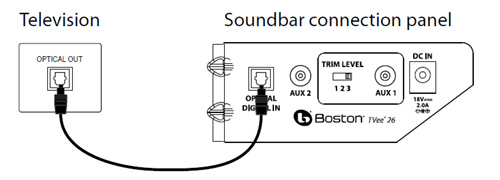

In terms of how to hook up a soundbar to a TV, there are usually a couple of choices. Many sound bars these days come with a digital (usually fiberoptic) input and an analog input. Your Boston Acoustics TVee Model 26 has a fiberoptic digital input plus two 3.5mm aux inputs (which look like headphone jacks). For best results and simplicity, I would suggest using the fiberoptic digital input. So plug an optical digital cable from the TV’s digital audio output to the sound bar’s digital input and you’ll be good to go.
You can then use one of the aux inputs to connect a phone, tablet or media player using a standard 3.5mm male to 3.5mm male stereo cable. In the unlikely event that your TV does not have a digital output (most do), then you can use the TV’s analog output or headphone output to connect to one of the 3.5mm aux input jacks on the TVee 26, but do this only if you can’t use the digital input.
