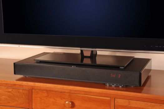

But ZVOX has always put performance first, which has led them to form factors that some might call unorthodox. Their Z-Base line demands far more real estate than a soundbar, requiring that room to house all of the necessary componentry and move all the air necessary to create a memorable sound experience, while still fitting neatly on a tabletop. And yet, because they re designed to be placed underneath a TV’s integrated stand, they may just be the perfect solution to some TV owners’ audio dillema.
The Z-Base 580 Single-Cabinet Surround Sound System is the best product the company has ever made, taking their strengths to the next level and applying lessons learned from the modest criticisms of previous generations. At 33 pounds, three feet across and over a foot deep, it’s big and it’s proud, and it doesn’t sound like any other single-speaker solution out there. Apart from the quality and configuration of the drivers, Z-Base products are renowned for ZVOX’s PhaseCue technology, now in its second generation.

Of course they didn’t overlook the convenience either, as we can set up the Z-Base 580 with just a power cord and a single audio cable. The included documentation has grown since their famous single-sheet days, as TVs and consumer demands have continued to evolve, but it’s still a simple process, now illustrated with helpful color photos. There’s even an extra piece of paper taped onto the top of the system’s protective plastic packing bag, warning us not to put anything heavier than 140 pounds (though they now say up to 160 pounds) or with a base size bigger than 34-by-15-and-a-half inches on top of the unit. ZVox says these size/weight guidelines should accomodate most flat panel TVs from 37 inches up to 72 inches diagonal, but we’d recommend closely checking your TV’s specs (or better yet, measuring the stand) before assuming it will fit safely on top of the Z-Base 580.
We should also make sure that the 580 is stable and level, and mind that we don’t incur any scratches on the textured roof of this thing, or on the tabletop beneath. To get the most out of it, I would recommend a hard wooden surface at least as big as the 580’s footprint. There is also a single port on the rear left of the unit, which might take advantage of reflectivity off of the wall behind the TV. My 50-inch Samsung plasma went on top of the 580 easily, but we would also do well placing the unit on a table or A/V rack centered in front of a wall-mounted television.

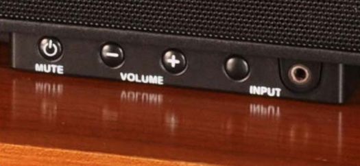

There are multiple digital and analog inputs around back (and one additional analog input up front), and many ways to connect. If our television offers a digital pass-through, optical or coaxial, we can patch that signal into the 580, or if we have an older model with an analog variable audio output–which allows us to raise or lower the volume just by using the TV’s remote control–that’ll work, too. There are more inputs than ever on the 580, even a stereo mini-jack to mate with a TV’s headphone out, or with a portable music player. Some of these options might require our own cabling, but a digital optical and RCA-type stereo cables are included in the box. Most of our testing was performed using the optical out of a PlayStation3.
Even during such a quick setup we can’t help but notice the exceptional build quality of yet another ZVOX product, the cabinet constructed of medium-density fiberboard and capped on the two ends with attractive hand-lacquered panels. Inside is a new highly efficient Class D digital amplifier that typically uses less than ten watts of total power even at high volume, with standby power about one percent of that, and an auto-shutoff feature that steps down to standby mode three minutes after you shut down the TV. This leads ZVOX to call the Z-Base 580 of the “greenest” audio systems we can buy.
A horizontal array of five matched full-range, long-excursion main speakers is backed by side-by-side dual 6.5-inch powered subwoofers that hit lows down to a reported 34Hz. A sub-out port is provided, for people who insist upon an outboard kicker. ZVOX has reported some compatibility issues with certain standalone subwoofers, due to the insufficiently strong signal via the 580’s sub-out, so buyer beware. But honestly I’d love to know hard numbers for who wants, needs, or actually uses an outboard sub with this booming slab.

The ten-button remote has two more keys than the previous-generation ZVOX 575‘s and it seems to do a lot more. A bright orange four-digit display glows at us from behind the hard, fine black grille of the 580, concisely reporting the current setting for volume, bass, treble and PhaseCue II, as well as indicating whether Mute, Output Leveling (“OL”) or Dialog Emphasis (“DE”) is engaged. These last two are quite significant, as the new Dialog Emphasis circuit enhances the frequencies of voices as other sounds are minimized, a lot like what a hearing aid does. And Output Leveling works a bit of compression alchemy to make the loud softer and the soft louder, helpful when changing channels, or when commercials appear. Weak Blu-ray/DVD signals are also boosted.
The 580 has a learning mode so that we can use our current TV remote for the basic functions of power, mute, and volume up/down. In fact, apart from the hard power switch, there’s no need to really touch the unit itself once it’s all set up. We can configure it so that powering up the TV will automatically turn on the 580, and, as mentioned earlier, about three minutes after we switch off the TV the 580 will go into standby mode.
