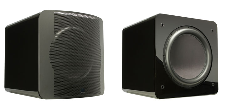

The SB13-Ultra subwoofer features a compact, sealed-cabinet design and measures a modest 17.4 inches in each direction. Although for some, 17.4 inches may hardly qualify as “modest,” compare that to the 47″ tall cylinder subs that made SVS famous – which they still sell – and you’ll understand why this is accurately categorized as a “compact subwoofer.” A subwoofer after Henry Ford’s heart, the SB13-Ultra is available in two finishes: piano gloss black and real wood veneer black oak. Protecting the front-firing, 13.5-inch driver is an attractive, curved metal grille (also black).

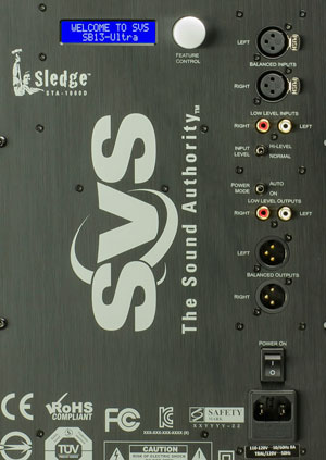

Around back you’ll find the rear plate of the integrated Sledge amplifier. Capable of outputting 1,000 watts RMS continuous power, this Class D amp provides both balanced and low level inputs and a matching pair of outputs, if needed. There too you’ll find a large silver knob which is used in conjunction with a small LCD to navigate the subwoofer’s configuration settings.
