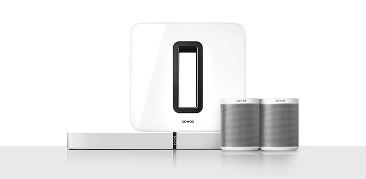

One thing you sometimes give up when you opt for the simplicity of a sound bar or sound base is surround sound. But with Sonos, you don’t have to. Like the Sonos PlayBar and their newest bar the Sonos Beam, the Sonos PlayBase can be expanded from a traditional speaker to a real multi-channel surround sound system. You can add a pair of Sonos Play:1s or Sonos Ones or use a Sonos Amp to power a pair of in-wall speakers in the rear of your room. You can also add a Sonos sub if you want deeper more powerful base – something that really enhances the whole home theater experience. Most of our listening was done with the full 5.1 channel system, with Sonos Sub and a pair of Play:1s added for rear channel duties, but we did do some testing with just the PlayBase on its own.

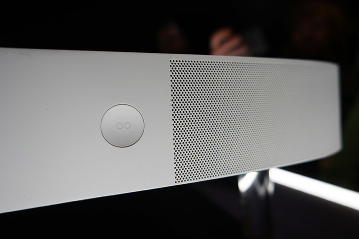

You might ask how the PlayBase can work with streaming music sources, streaming video apps, cable boxes, etc. if it only has a single input. And that’s a good question. The answer is “intelligent engineering.” In terms of switching the sound between the TV and streaming music, that’s actually automatic. When the PlayBase detects a signal from a video source like a TV or cable box coming over the optical cable, it automatically turns itself on and switches to that source. If you go into the Sonos app and decide to play music on the PlayBase, then it automatically switches to that source. And if you have multiple video sources like a Blu-ray Player, Roku streaming box and a cable box, simply plug these directly into your TV and let the TV handle the audio switching for you.

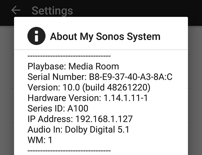

The key to getting great sound out of a Sonos surround sound system, whether that’s a PlayBar, PlayBase or Beam, is making sure that you are indeed getting true 5.1 channel surround sound to the system. Generally speaking, most TVs will pass a 5.1-channel Dolby Digital signal if you are using the TV’s built-in digital tuner or one of the on-board streaming apps like Netflix, or Amazon Prime. But it can get a bit trickier if you are using an external source like a Roku box, AppleTV or a Blu-ray player. We’ve written a whole tutorial about this, which you might find helpful if you’re having trouble getting your 5.1 on:
To check to see if you are getting 5.1 sound, first make sure you are watching 5.1-channel content on your TV. There are plenty of movies and shows on Netflix, Vudu and Amazon Prime Video that are in 5.1. Any recent wide release movie or big budget series should have a 5.1 channel option. Once that 5.1 channel material is playing through the PlayBase, go into the Sonos App, “Settings… About My Sonos System.” If you have multiple Sonos speakers in your system, scroll to find the PlayBase on the list. Under “Audio In” it should say “Dolby Digital 5.1.” If it does, your PlayBase is receiving a 5.1 channel signal and it is working as expected. If instead, the Audio Input says, “Stereo” then you’re only geting two-channel sound from your TV, and your surround sound will be limited. If you can’t get that “Dolby Digital 5.1” to show up, then definitely read the tutorial for suggestions on how to fix that.

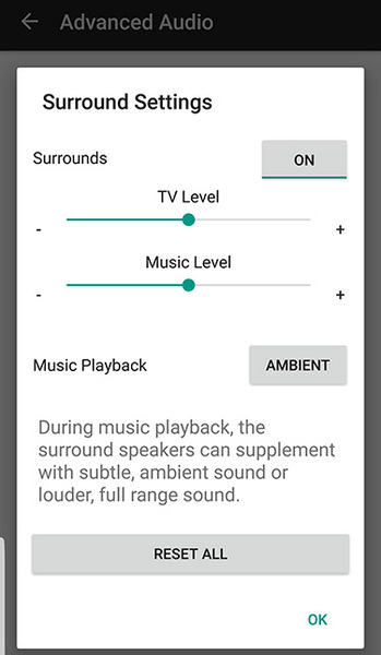

If you don’t have access to an iOS device, or if you’d like to make manual tweaks to the surround sound settings, you can adjust those in the Sonos app under “Room Settings… Advanced Audio Settings.” You can set different surround sound levels for “TV” (any source connected to the fiberoptic input) and for “Music” (any music source coming through the Sonos app). If you find yourself craving “Mo Bass” (or less), you can adjust subwoofer levels in that same Advanced Audio Settings menu.
In addition to the level of the surround sound speakers, you can select “Ambient” or “Full.” These settings really only apply to how the system handles two-channel (stereo) input, like music from your digital collection or favorite streaming service. With “ambient,” the system will decode non-specific ambient sounds in the incoming audio signal and place these in the rear to create a deep full soundstage. With “Full” you basically get the stereo sound from the front duplicated in the rear speakers. This is good for parties if you want to fill the room with sound.
If you’re more of a stereo purist, you can turn the rear channel speakers down or all the way off for music listening. This will reproduce all of the sound from the PlayBase (or PlayBase plus subwoofer).
