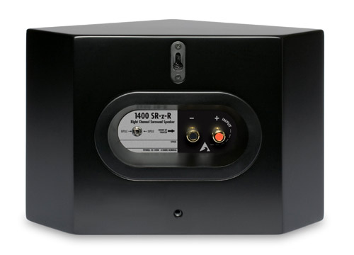

The 1400 SRz is actually both bipolar and dipolar: it’s switchable between the two modes, depending on your preference. In either case, drivers on each side of each enclosure emit sound in two directions for an immersive height channel effect. In bipolar mode, the two drivers put out the exact same sound in two different directions. In dipolar mode, the sound from one side of the speaker is in phase while the other side is out of phase.
Dipolar configuration will generally create a more diffuse surround soundstage where the location of the actual speakers is difficult to discern (this is particularly good for movies), but because the drivers are out of phase from each other, the overall sonic balance in areas outside the “sweet spot” may be compromised, particularly when you consider that the height channel speakers are being placed directly above the main speakers. In comparison, bipolar speakers create a more discrete soundfield with more localizable sounds, while still maintaining a more diffuse sound than traditional front-firing dynamic (“monopolar”) speakers. For our listening, we set the mode switch on the SRz speakers to “bipolar” as this led to the most enjoyable results in our specific room, with a diverse set of source material. But owners might like to experiment with both modes. If you use dipolar mode, be certain you arrange the speakers properly with the arrows pointing toward each other. Also, keep in mind that the 1400 SR-z also makes a fine surround sound speaker, for rear and side surround channels. And in these applications, you may prefer the sound in dipolar mode (again, some experimentation is always useful).

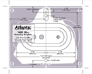

Setting up the 1400 SR-z is simple. It comes with a cardboard speaker template for each speaker so you can visually preview exactly where they will be placed on your front wall (complete with mounting holes so you’ll know where to place the mounting screws or nails). Recommended placement is at least three feet above your main front left and right speakers and directly above them or slightly wider. The high quality, gold-plated, spring-loaded speaker terminals don’t accept banana plugs, so just use bare wire or pins and you’ll be ready to rock.
