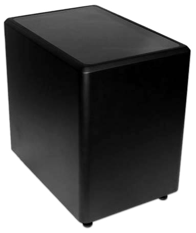

Belying their affordable price, the LFM-1s have an exceptionally high degree of fit and finish. Even the packing material screams “high quality” with a soft cloth sack protecting each subwoofer inside two sturdy layers of foam and cardboard. The subwoofer itself is available in any color you want, as long as you want black.
The satin black wood veneer is enhanced by an integrated smoked Plexiglas top, which allows the subwoofer to function as a fine-looking end table or plant stand without fear of spills or condensation. Actually, in a variation of the WAF (Wife Acceptance Factor), or politically correct “PAF” (Partner Acceptance Factor) I should comment on the MAF (Mom Acceptance Factor). My mother was visiting her grandchild (and her son and daughter-in-law, of course, but mostly her grandchild), and during one of our charming young son’s naps, my mom noticed the Outlaw subs and just loved ’em. And she’s not usually one to gush over stereo components (OK, she does like my Martin-Logan electrostats, too). So fear not the approval of your fashion-tuned significant other.

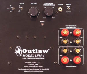

The rear controls are pretty standard fare for a powered sub these days – power (on/off/auto-on), phase (0 or 180 degrees), level control and crossover frequency controls (continuously variable from 40 Hz to 180 Hz, or bypass). Connections support both speaker level and line level inputs. And as for its power, the internal BASH amp is rated at a whopping 325 Watts RMS (1300 Watts peak). I can tell you in all my punishing listening tests, I never heard these subs even begin to strain, so I don’t have any reason to doubt the veracity of this claim.

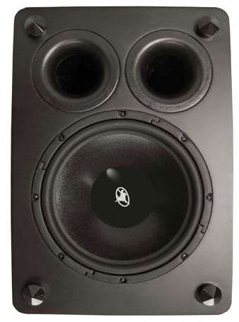

- Driver Type: Down Firing, 12″ Long-throw Woofer
- Ports: Dual
