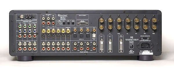

Setting up the 1070 was relatively easy. There are two parts to setup. The first is connecting all the speakers and the components to the receiver, the second is adjusting the system to match your specific listening room and speakers. In connecting the 1070 outputs for the speakers, there are two options: use the internal amplification from the 1070 or bypass the 1070's amplification and use an external amp. Although the 1070's internal amplification at 65 Watts/Channel is perfectly adequate for most speakers and most small to medium-sized listening rooms, an external power amp can make sense if you have a larger room, or inefficient speakers, or just like having some extra headroom for those particularly taxing musical or theatrical interludes. I chose to use an external power amp for the front speakers only, but did do some listening with the receiver in "stand-alone" mode as well.
With all the speakers connected, then you need to connect the components. Brief aside: it's always best to do all this with the power off or better yet, the receiver unplugged from the wall so you won't get any nasty noises that happen when you plug in and unplug audio and video connectors and speakers. The 1070 supports nearly every input available today with the exception of HDMI. For video, you've got DVI, composite, s-video and component inputs. For audio, you've got standard analog RCA jacks, optical and coaxial digital inputs. And if you have devices that only have HDMI outputs, you can get inexpensive HDMI to DVI adapters if you want to route the digital video signal through the 1070 for switching.

Ergonomics and Ease of UseThe 1070 has more inputs and outputs than I could possibly ever use. It supports high definition video switching via component video or DVI, and switches standard def video sources via component, S-video and composite inputs. Relatively rare in a value-priced receiver, the 1070 also offers transconversion of the standard definition analog video sources (composite and S-video) to component video and vice versa. This means you can plug in a VCR into the composite input, a camcorder into the S-video input and a DVD player into the component input, and all of these sources will be available via the receiver's component video, composite and S-Video outputs. This allows you to use a single video cable between your receiver and TV which simplifies things a bit. Yes, there is no HDMI switching, but you can easily convert an HDMI output to DVI (albeit without the audio signal) and still use the 1070 to switch the video source. You can also just plug the HDMI source directly into your TV, but still use the Outlaw to process and switch the audio signal via a coax or fiberoptic digital cable.

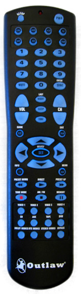

The 1070's remote is ergonomically pleasing to hold. The buttons all light up blue when pressed which makes it very easy to make adjustements in a dark room. However, the remote is odd in a couple of ways. The power button is only used to turn the 1070 off. To turn on the 1070 you need only select the source input. This was surpising since I have never seen any other remote act in this manner. Also, the 1070 is capable as acting as a universal remote, so you may have to press the "TNR" button before selecting the source if for some reason the remote was used to control some other input. While not really a problem, prehaps the power button when pressed could also turn the 1070 back on to the last source as a default as well. That would be the best of both worlds.
