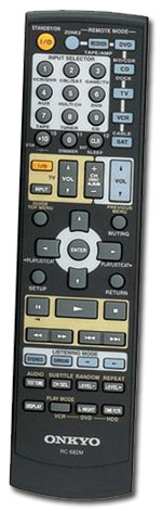

The included remote control is logically laid out, with buttons for direct input selection and backlighting on some of the important buttons. It can be programmed to operate up to six different devices, including a TV, CD player, cable or satellite box, DVD player and the receiver itself. In addition to controlling receiver functions, the remote includes buttons for menu and transport control of a compatible disc player or source device. If you don't already have a universal remote control, this one will definitely get the job done, controlling the basic functions of multiple components within your home theater system.
