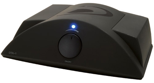

The Dayton Audio DTA-1 has the footprint of a roll of paper towels, but is rated at 15 watts per channel RMS into 4 ohms @ 10% THD. At lower levels of distortion, it’s got a claimed 10 watts at 0.1% THD. Not bad, even if that is only 5 watts per channel into 8 ohms (maybe). In reality, most audio listening is done at 1-3 watts, so 5 should be plenty for a small system, right? I don’t know, but it’s so cute I’m looking forward to finding out.

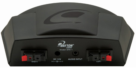

You can’t tell from the pictures, but the rubberized texture of the DTA-1 belies its price. The overall fit and finish is surprisingly good for such an inexpensive product. It doesn’t even look bad sitting on a table between two speakers. On the back you get spring clips for the speaker wire (and these are rather small, so you won’t be hooking up your 8 gauge speaker cable to this one). There’s only one input, a stereo 1/8th-inch jack. An 1/8th to 1/8th cable is included so you can hook up your iPod or laptop or whatever right away. Nice thinking.

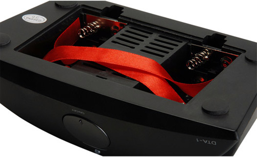

There are two options to power the DTA-1: eight AA batteries, or the included switching wall wart.

Using batteries was another story. Even though output tests like those above remained very similar, it was clear listening to music that the amp couldn’t handle quite the same volume levels as when plugged in. More distortion was evident at max volume. As far as battery operated amps go, though, you’re still getting a lot more, and better, sound than you’d expect. So if you want to create a portible system with some speakers you already have, the DTA-1 can fulfill that role very well, though it’s even better plugged in.
