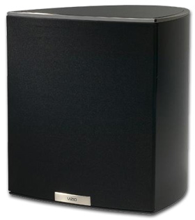

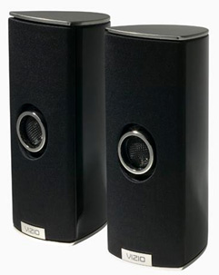

Once your source components are plugged in, there isn’t a whole lot else to do except connect the subwoofer and surround speakers. But don’t look around for a jack for these on the bar itself. The subwoofer and rear speakers are wireless. The subwoofer module has a wireless receiver built-in and it includes the speaker jacks for the rear speakers. These are clearly labeled, so you won’t mix up the left and right channels. Yes, there are wires from the wireless subwoofer module to the rear speakers but these should be easy enough to hide behind a couch or along a baseboard using a raceway or wire channel. Place the rear speakers somewhere in the back half of the room (preferably behind you, equidistant from your main listening position) and you are good to go.
If placement of the rear speakers behind you is not feasible, you can put the VHT510 into a “Front Surround” mode with the surround speakers placed to the left and right of the soundbar. In this mode, SRS Circle Surround HD can be used to create a virtual surround soundfield. Our listening and evaluation was exclusively done with the soundbar’s standard Rear Surround mode (the default).
VIZIO says their 2.4 GHz Wireless HD Audio technology allows the subwoofer module to be placed up to 60 feet from the sound bar. Ours was more like 12 feet away, and we had no noticeable problems with interferences nor with the unit losing the signal. The subwoofer placement isn’t too critical as low bass frequencies are mostly non-directional. Now all that’s left to do is plug the sound bar into a power source, and do the same for the subwoofer/wireless amp module and you’ll be ready to rock.

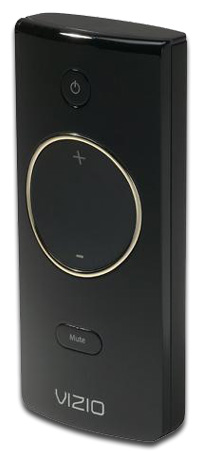

Of course, the VHT510 comes with its own remote control, and it offers quite a bit more control than you might expect from a simple sound bar. The basic controls (power, volume, and mute) are visible on the front, as well as playback controls for an iPod if you add VIZIO’s optional wireless iPod dock. There is also a small slide-out panel that reveals individual level controls for the subwoofer, center and rear speakers, bass and treble controls, and direct input selection. There are also buttons to enable SRS TruVolume and SRS WOW and SRS TruSurround HD (more on those later).

I was a little worried that having the subwoofer in the back of the room might be distracting, as it provides bass for the whole system, including the front three channels. Rear placement is not absolutely required, but since the subwoofer module also includes the speaker jacks for the rear speakers, it’s likely that you will position the subwoofer near these rear speakers. But the sub kicks in at a low enough frequency that it doesn’t draw too much attention to its position. Turn the sub off though, and you’ll definitely miss it — the sound bar on its own doesn’t do much in the way of low bass. Overall, the transition from lower midrange to upper bass was fairly cohesive. The upper bass, around 80-120 Hz, is not particularly prominent, but I’ll take this over excessive boom any day.
