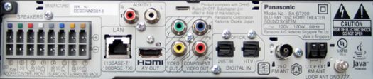

I’m reluctant to call the central component of this kit an “A/V Receiver,” as it mostly receives audio signals, without any video input per se. If you’d like to connect a cable or satellite set-top box or game system, your best bet is to connect the video directly to your TV (e.g., HDMI or component video) and then connect the audio to the BT200’s digital or analog audio inputs. One video source that you can hook to the system is an iPod, via the adorable slide-out iPod dock drawer tucked inside the front panel. This integrated dock is compatible with just about all iPods (except the Shuffle), from mini, to classic, to nano to Touch, but is not officially certified for iPhone. If you put your iPhone in “airplane mode” however, it will work perfectly fine.

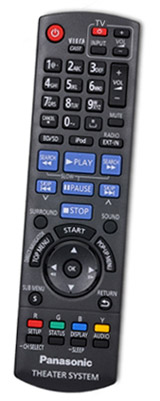

The BT200’s remote control allows you to control the functions of the iPod as well. Even lower bitrate music sounds lovely, full-bodied and nuanced, with the option to hear stereo tracks through all seven speakers and sub via Panasonic’s proprietary surround processing.
To access all Profile 2.0 features (i.e. BD-Live downloads) you’ll need to connect a network cable between the BT200 and your home network router, and you’ll need to add a one-gigabyte-or-higher SD or SDHC card. USB flash drives tend to be more readily available, at least between the sofa cushions at Rancho Chiarella, but Panasonic was the co-creator of the SD format, after all. With a loaded SD card, you can also quickly deliver digital music, AVCHD videos and photos to the home theater. Network set-up through my HDCP-enabled router went off without a hitch.

Upon initial system startup, I was prompted to update from firmware v.1.2 to v1.3, easy enough via broadband internet, although it took several minutes to complete. In general, I found boot-up and responsiveness to the remote to be a bit sluggish. The unit even bothers to display “PLEASE WAIT” during warmup, it’s so slow. Also, sadly the Eject button found on most Panasonic Blu-ray Disc player remotes was missing from the BT200’s.

Features/Specifications of the SC-BT200:
- MSRP: $499.99
- Subwoofer Level Control
- Video D/A Converter 148.5 MHz/12-bit
- Audio D/A Converter 192kHz/24-bit
- HDMI Out (1)
- Component Video Out(1)
- Digital Optical Audio Input (2)
- Analog Stereo Audio Input (1)
- Composite Video Out (1)
- Headphone Out (1, mini-jack)
- Wireless Terminal (1)
- Ethernet Port (1)
- Supported Disc/File Formats: BD-ROM, BD-RE, BD-RE DL, BD-MV (BD-RE version3), JPEG (HD), BD-R/ BD-R DL BD-MV (BD-R version2), DVD Video, DVD-ROM DVD Video, DVD-RAM DVD-VR, JPEG (HD), AVCHD, DVD-R/DVD-RW/DVD-R DL, DVD+R, DVD+R DL, DVD+RW, CD, CD-DA, CD-R/-RW MP3
- SD Memory Card Slot (1, SD/SDHC)
