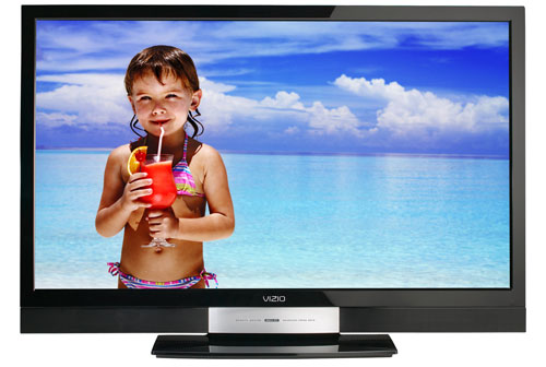

Like its predecessor/sibling, the SV470XVT, Vizio’s SV471XVT continues the manufacturer’s tradition of delivering solid-performing, well-equipped displays at an affordable price. The 471 offers a handful of improvements over the 470, chief among them a brighter panel, (arguably) improved motion processing and a USB port for photo and video playback.

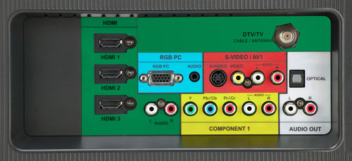

The SV471XVT comes well equipped to handle the bulk of your connectivity needs. On the rear jack pack you’ll find three HDMI ports with a fourth conveniently located on the side panel. For analog HD connections, you get one component video input out back and another on the side panel. Composite and S-video ports are also available but if you know what’s good for you you’ll avoid using these at all costs. Flat panel HDTVs have a hard enough time with standard definition programming as it is. If you deliver it via composite or S-video, you’re just asking for trouble. Rounding out the connections, you’ll find a VGA/PC input on the back panel and a USB port on the side panel – a convenient location when connecting flash drives or an external hard drive. I tried the former and browsed a few photos with relative ease. It should also be noted that the SV471XVT lacks internet connectivity, so you won’t find an ethernet port or integrated wireless on this display.
Rather than hook up my full surround sound rig, I simply connected my DISH Network ViP722 satellite receiver and Philips BDP7200 Blu-ray Disc player using BetterCables HDMI and component video cables, respectively. While switching between inputs, I noted an interesting capability of the SV471XVT. Although many modern displays and projectors (including the SV471XVT) allow you to maintain different picture settings for each input, the SV471XVT also maintains independent volume controls, remembering the last volume used for each. This is helpful if one of your devices is frequently louder or softer than standard television, but it can also be frustrating when you’re trying to keep quiet at night and you switch inputs only to find the volume much louder than it was a minute ago.

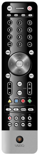

Ergonomics and User Interface (UI) can make or break long-term satisfaction with any piece of gear – especially your television. The SV471XVT gets fair marks in this department – but they could be better. The supplied remote is well-designed and the most commonly-used controls (Channel, Volume, Source) are all smartly placed on the bottom half of the remote for convenient thumb access. The cursor pad was my only major complaint; it felt rather chintzy and was somewhat temperamental when it came to registering clicks.

Whether it was U.S. Open tennis on DISH’s TennisHD network, or the Blu-ray edition of the film Drum Line (an exceptional-looking disc – thanks for the recommendation, boss) the SV471XVT put forth a bright, mostly uniform and accurately-colored picture. As a matter of fact, the 1080p/24 image on Drum Line looked staggeringly good at times and my only real complaint pertained to viewing angle; the SV471XVT’s viewing angle is quite narrow and as such I wouldn’t recommend sitting at the far end of the sectional sofa when watching this TV.
