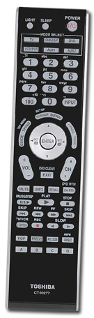

As a high-end television, it’s nice to see that Toshiba did not skimp on the remote control. It’s relatively large but feels comfortable in the hand and offers full backlighting of all keys “??? a very nice touch missing from many supposedly high-end components including Toshiba’s own latest generation of HD-DVD players. It is a universal model capable of being programmed to operate multiple devices but at this level, you’ll probably be using the set with a more advanced 3rd party universal remote so it’s likely that the universal features of this remote will go unused by many owners.
The commonly used "pic size" button on the remote (aspect ratio control) nicely brings up a menu of available aspect ratios, which varies depending on the input format used and its resolution. You can select from these aspect ratios via the circular central controls, or by simply hitting the "pic size" button repeatedly. And if you enable the "Auto Input" feature then you can even use the "mode" buttons to switch directly to specific inputs. E.g., if your DVD player is connected to the "HDMI 1" input then you can associate the HDMI 1 input with the DVD mode button on the remote and switch to that input with a single press of a button.

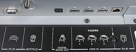

Set up of the internal tuner was a straightforward process. With a rooftop antenna feed, the set was able to find all of our local HDTV and digital channels without any problems. HDMI and component inputs worked properly as did the PC (VGA) input, though that input is limited to 1024×768 resolution. If you’re going to use this with a PC you’re much better off using one of the HDMI inputs (which can be easily adapted from a DVI-D connection if your PC happens to have one of those).

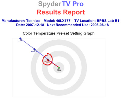

Testing, TestingBefore digging into the TV and settling down for any critical viewing, we first had to calibrate the set. Like virtually all of the HDTVs on the market today, out of the box settings are not ideal. The "Sports" setting may look nice on the showroom floor, but is downright garish in the subdued lighting of the home. The "Cinema" and "Pro 2" settings were actually reasonably accurate so, if you want to enjoy the set without any fuss or bother, these are a good start.
For calibration, we used the SpyderTV Pro colorimeter and software package, starting with the "Pro 2" setting, with backlight set to 30 and making some tweaks to color, contrast, brightness and tint. The default sharpness setting proved to be too grainy, but dialing it down to 20 looked right. The "warm" color temperature setting in the Advanced Picture Settings menu is the closest to 6500 degrees NTSC standard, but it’s still a bit cooler than that standard. The final slider settings are noted below.
