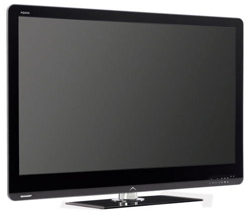

After un-boxing the LC-40LE810UN and assembling its included stand, I took a step back to take in the aesthetic of Sharp’s latest panel design. Sadly, I was also able to take in some of my living room floor thanks to Sharp’s unfortunate decision to burden the chunky bottom bezel with a highly-reflective mirror coating. This mirrored stripe, which is home to a row of touch-sensitive control buttons, may look sharp (hey!) in a contemporary living space, but the last thing I want to see on my display’s bezel is a fun house mirror. Not only did it give me a distorted view of my living room rug, but it routinely distracted my eye while attempting to watch television. Sharp engineers, if you’re listening, I have two words for you: matte finish.

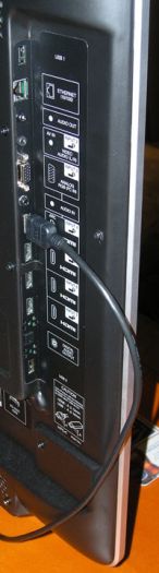

The LC-40LE810UN is definitely thin, and its attractive tabletop stand allows for a good degree of swivel, feeling relatively sturdy overall. Video connections are abundant, but their location and numbering is less than ideal. In most installations, your source wiring is coming through the wall behind the display, or up from the floor below. This is why most displays have rear- or bottom-facing inputs, typically near the bottom of the panel. Most displays, but not all.
Last but not least, the numbering Sharp has assigned to its inputs is rather bizarre. These days, most consumers are using HDMI-equipped devices for their source equipment. Whether it’s a cable box, satellite receiver, or Blu-ray Disc player, HDMI is everywhere and informed consumers appreciate its high quality and one-cable simplicity. On the LC-40LE810UN you get seven numbered inputs and the HDMI ports are #4-7. This would not pose a problem if the LC-40LE810UN had one-button access to its inputs, or at least an “HDMI” button to toggle amongst those four popular inputs – but it does not. You’re instead forced to repeatedly hit the “Input” button and tap down-down-etc. to select your desired input. You can skip certain inputs, but you cannot skip the built-in TV tuner nor can you skip Input 2, which is a mini-plug (!!) for older camcorder or gaming console connections. Very strange.

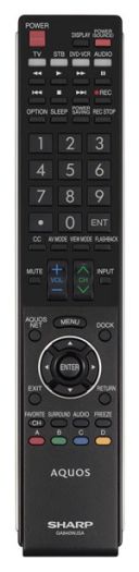

Despite its lack of backlighting, Sharp’s new remote control design is quite good. If you’re one to use your TV’s Volume and Channel buttons, this remote has them dead center and right where they should be. The cursor pad is fine, albeit a tad spongy for my taste, and most actions begin with the “Menu” button which sits atop the pad.

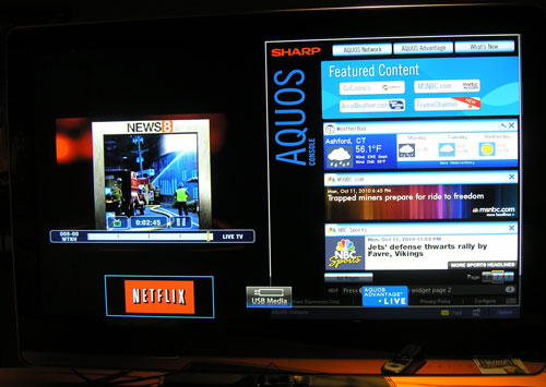

Sharp’s redesigned on-screen menu system and graphical user interface (GUI) is an unfortunate case of form over function. The horizontal main menu is attractive and intuitively grouped, as is the corresponding right-edge sidebar. However, navigation is quite sluggish and not always consistent. There are times when holding the down button made the cursor box move relatively quickly, while at other times it was downright tortoise-like. The worst offender in the “form over function” department is definitely the web content.
Web 1.5
Five years ago, a display’s menu system and how intuitive its GUI was never garnered much attention. Sure, some were better than others, but it was pretty hard to get lost and no one really cared if the “Clock Set” icon was shiny and had a drop shadow. The most complex procedure you tackled was probably setting up a Favorite Channels list, and again, it was usually pretty straightforward. However, much has changed in the last few years and the advent of Internet connectivity and TV-based video streaming services such as Netflix have significantly altered the landscape. Like our cell phones and a growing number of appliances, televisions have become miniature computers. They no longer “turn on” so much as they now “boot up,” and firmware and software updates have become commonplace. And like all good websites with a constantly-growing array of content, display interfaces have evolved to become more intuitive, more personalized, faster, and simpler to use. Or at least, that’s the “web 2.0” expectation.
I titled this section “Web 1.5” because Sharp’s LC-40LE810UN has many of the ingredients for a cutting edge connected display (e.g. Netflix streaming and web-powered widgets) but the more I use it, the more it feels half-baked or bolted-on. For example, web-based content is split between two areas and the remote uses two buttons to differentiate them: DOCK and AQUOS NET. Pressing Dock gives you a subtle toolbar along the bottom of the screen and there you’ll find Netflix, access to connected USB media and a link to AQUOS Advantage Live, which provides TV software updates and an on-screen version of your Owner’s Manual as well as the option for live support.
On the other hand, AQUOS Net (not to be confused with AQUOS Advantage Live) opens an entirely different side toolbar, and there you have access to Sharp’s content partners and widgets, such as WeatherBug, NBC Sports and Access Hollywood. Unfortunately, launching the contents of said widgets is cumbersome (you can’t just highlight the widget and hit ENTER?) and – more annoying – the act of launching a widget immediately switches the active input over to the TV’s built-in tuner. In my case, I was often viewing HDMI input 4 when I’d opened the AQUOS Net sidebar and launch the NBC Sports widget. The widget would open on the right side of my screen, but the left side (my Dish Network TV signal) was promptly booted in favor of a fuzz-filled channel 4 on the TV’s built-in tuner. (Note: according to Sharp, they are aware of this issue and they’re working on a fix.) I could go on here, but the bottom line is that Sharp has a lot of good content here that’s unfortunately mired in a clunky, dated and buggy user interface.
