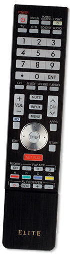

The remote control is well laid out, and features pinkish-amber backlighting. The number keypad is highly legible, and the remote can control a satellite or cable tuner, a Blu-ray or DVD player, and an audio system.
Surprisingly, when I first powered up the Sharp Elite, my Pioneer Elite Kuro plasma (which was parked right next to it) powered up too. I grabbed the Pioneer remote and found that it controlled the Sharp. Why Sharp decided to use Pioneer codes instead of their own is a bit of a mystery. It’s really no big deal, except in the case where an owner wants to use a programmable system remote control, and programs it with Sharp TV remote codes (which would only be logical, right?). Those codes won’t do anything with the Sharp Elite.
Just under the cursor keypad resides a dedicated and prominent Netflix button. Word from a TV industry insider is that Netflix provided some sort of incentive to Sharp to place that button there – seems that the streaming pay TV business is more competitive than I thought.

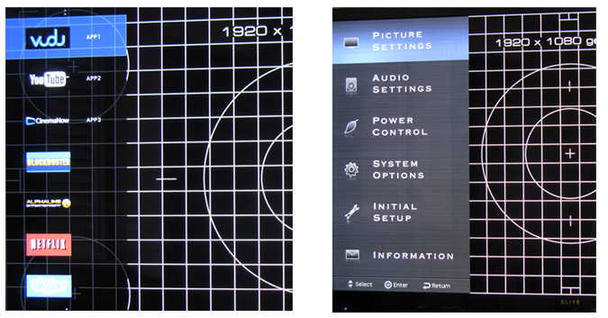

The Elite’s OSD is blessedly uncluttered, with a half dozen logical sub-groups, clear text, and fine picture adjustment granularity. When called up it occupies about half of the left side of the screen. When adjustments are being made, the control stays on screen at bottom center, leaving the rest of the screen uncluttered, and the control doesn’t run and hide after a few seconds of non-use (calibration technicians really appreciate this capability).
Adjustments for the set are pretty much where you’d expect them, and an available Audio Only mode blanks the screen to save energy, which is a nifty feature that let’s you listen to your favorite talk shows or music channels when you don’t feel the need to watch the program.
