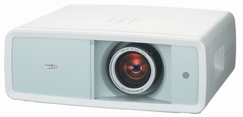

Those of you who have been following the pre-release hype for the Z2000 already know that its body leaves a little to be desired. Sure enough, while at first glance the Z2000 appears to be a bit smaller than its competitors (most notably Panasonic's
PT-AE1000U), the SANYO's antiseptic, eye-plaguing white color makes it appear twice as large. Since the colors it displays more than make up for the shade of the unit, I hope, dear reader, you can forgive SANYO for this misstep. After all, a ceiling mount is probably the most common way to install this, and most ceilings are white. If, however, the powers-that-be at SANYO would care to release a version in, oh I dunno, say, black. I'd be the first in line.

It’s Pixel-icious!In terms of what's new in the PLV-Z2000 over previous models, the biggest thing is the resolution – a full 1920×1080 pixels, also known as "Full HD." This is more than twice the detail of the PLV-Z5's 1280×720 resolution. And while those extra pixels may not make a big difference on smaller screens, they do come into play in the front projection space, where screens may be 100 inches, 120 inches or more, and first row seating may be a screen width away or less. More pixels means a clearer, sharper image from anywhere in the room.
The SANYO is one of the first projectors on the market to use Epson's new D7 Superfine 3LCD chip set. The D7 is made of an inorganic LCD substrate which is said to be more durable than previous 3LCD chips (longer lifespan). The D7 panels are also capable of much better contrast and black level than earlier LCD microdisplay devices, something that has always been a bit of an achilles heel for LCD projectors in the past. Because the light engine has three separate panels – one each for red, green and blue – it does not need a color wheel, and it supports a much wider degree of optical lens shift than single chip projectors.
You've heard (or read) me say it before and I'll say it again: nobody lens shifts like SANYO. The PLV-Z2000 continues SANYO's long-standing tradition of lens shifting like nobody's business. With a horizontal lens shift range of +/- 50% (2 screen widths) and a vertical lens shift range of +/- 100% (3 screen heights), the Z2000 can be positioned almost anywhere your heart desires. Lens shift is far superior to electronic keystone correction, as it loses no resolution and suffers no geometric distortion in the process. For the spatially-challenged (New York Audio-Video-philes, I'm looking in your direction), this is a must.
Did I mention the fan noise? I didn't? Oh. That's probably because I couldn't hear it. According to the documentation, the large aperture Sirocco cooling fan never rises above 19dB in economy mode. If they say so. All I know is, I have a pretty sensitive ear, and this is the quietest projector fan I've heard (or

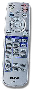

If you don't have the Harmony or some other universal remote, however, the SANYO's included remote will definitely do the trick. With a bright orange backlight and large buttons, the Z2000's remote is a snap. It even has one-touch buttons for each different input (Component, HDMI, etc) and Image setting (Presets and User-defined).
