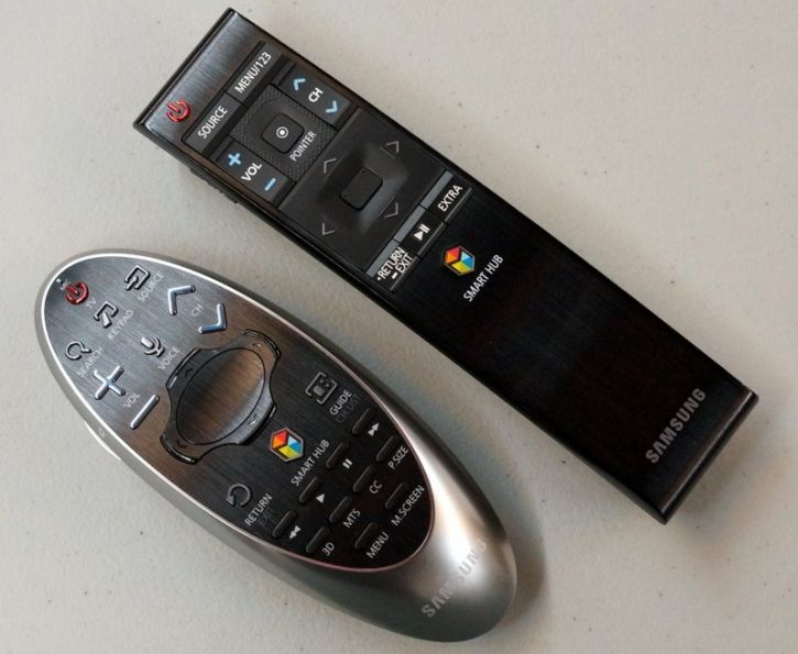

The new Samsung Smart Control remote’s slim curved baton-style design feels great in the hand, and its brushed finished face and textured back effectively minimize fingerprints. The relatively compact remote has just enough heft to give it a substantial feel, and sculpted finger grooves assisted with proper orientation and grip. Although the new remote has a partially backlit keypad for use in dimly lit environments, its separate directional pad and pointer activation button lacked the tactile feedback and ease of blind location of its predecessor’s larger combined control configuration. The new remote’s Nintendo Wiimote-like cursor control proved accurate and jitter-free making the lack of a traditional remote a non-issue for me.

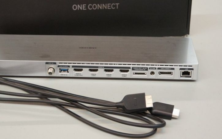

The JS9500 locates all A/V ports in an external box dubbed the One Connect. This box links to the back of the TV via a custom 2-meter data cable; the 78-inch and 88-inch JS9500s include a 3-meter cable. Samsung indicated that One Connect cable lengths beyond 3-meters were unlikely due to the system’s extremely high data rates so wall mounting configurations may be limited if an in-wall wire run is desired. The purpose of this external box? Upgradability. If some new connector gains traction in the future (HDMI 3?), owners of the JS9500 will need only to replace a small affordable input/output box, instead of a large expensive display panel.
The One Connect box incorporates four HDMI ports, three USB ports (one USB 3.0 at 5V/1A), and a dongle that provides legacy analog connections. All HDMI ports accept 2160p video input at 60Hz with 4:2:0 color sub-sampling, 2160p at 30Hz (4:4:4), and 4096×2160 at 24Hz (4:4:4). A menu option enables 8-bit 4:4:4 input at 60Hz; 10-bit and 12-bit input at 60Hz require 4:2:2 or 4:2:0 component video signaling. All HDMI ports are HDCP 2.2 enabled for use with protected UHD video source devices and content. Samsung informed me they will eventually offer an update to enable HDMI 2.0a for compatibility with upcoming devices such as Ultra HD Blu-ray players but further details were not provided.

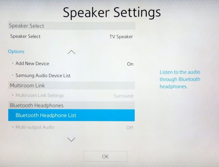

The SUHD TV’s wireless networking options include Wi-Fi (802.11 a/b/g/n/ac), Wi-Fi Direct, and Bluetooth. Samsung’s Bluetooth implementation in its televisions has long provided mouse and keyboard support (convenient for use with the built-in web browser), and the JS9500 adds Bluetooth headphone compatibility for wireless private listening options.

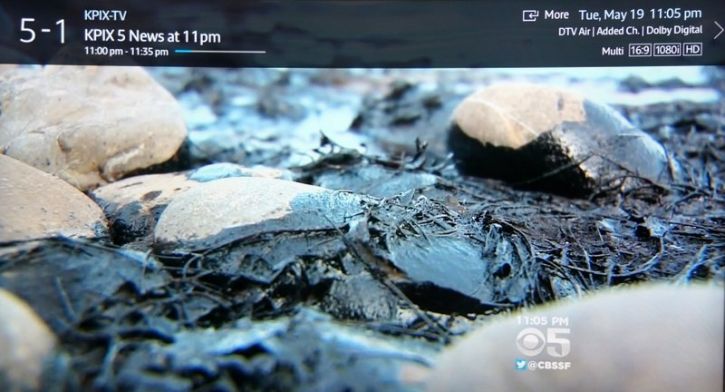

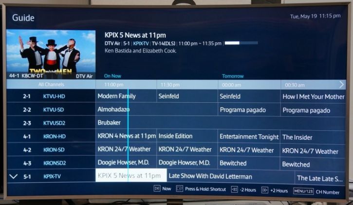

Cord-cutters will find the JS9500’s Over the Air (OTA) digital tuner delivers fast channel scanning and superb sensitivity for pulling in local stations. Program information at the top of the screen includes audio and video format details, date and time, and station identification. Channel surfing using a scrolling pop up menu on the right side of the screen is simple and speedy, however, paging through the attractive full screen channel guide can be a bit sluggish leaving you waiting for information to populate the grid-style presentation.

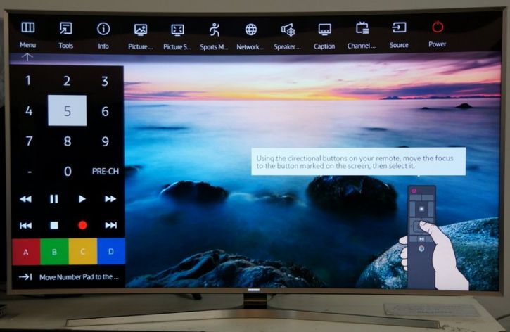

Don’t get too excited by the on-screen remote’s record button as this DVR-style feature is disabled for North American markets.

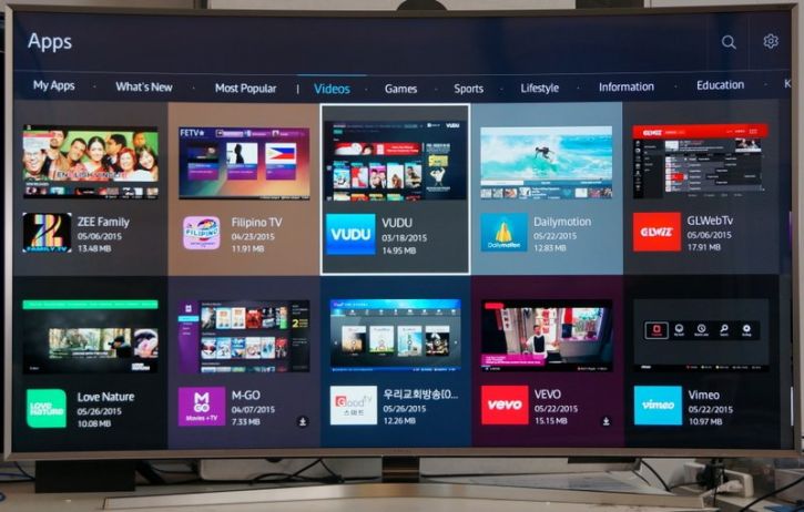

Samsung’s switch to its Linux-based Tizen operating system for its 2015 smart TVs is a mixed bag. The updated interface, with its larger app tiles, appears crisp and appropriately detailed for a 4K UHD screen. I also like being able to finally use the on-screen cursor with Netflix, but many other apps including Pandora, Vevo, M-Go and others have not received a cursor control update. As a baseball fan, the lack of the MLB.TV app is disappointing. I believe more will be upset with the absence of HBO Go. Also, Samsung’s own Milk music platform failed to make the transition – perhaps unsurprising given recent layoffs in that area.

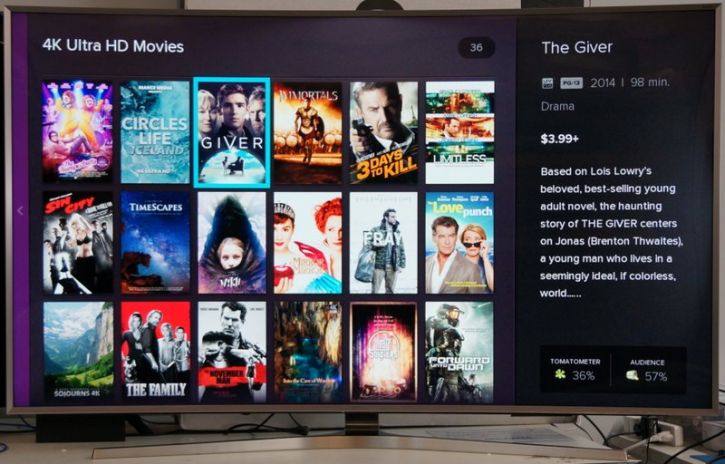

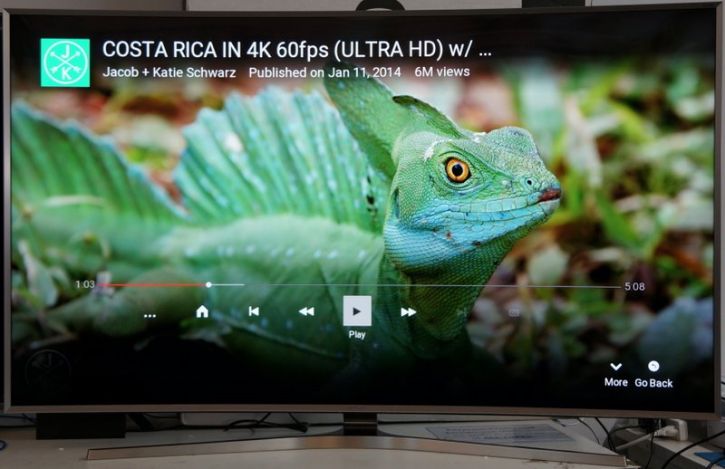

UHD streaming via Amazon Instant Video and Netflix remains appreciably more detailed compared to the 1080p equivalents. M-Go, UltraFlix, and YouTube further expand the JS9500’s selection of 4K viewing options, but the Xfinity UHD streaming app has yet to appear in SUHD-ville. While we were finalizing this review, Amazon announced HDR (High Dynamic Range) would be available, starting with season 1 of the Amazon original series, “Mozart in the Jungle.” You’ll find more about that below in our “UHD Viewing” sectrion.

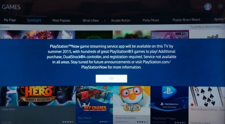

Given the crappy selection of games on most smart TVs and the often worse ability to adequately control the action, I was especially pleased to see that Sony’s PlayStation Now game streaming service would be a standard SUHD feature. However, a message on the app’s placeholder indicates that it won’t arrive until later this Summer.
Update (7/19): The JS9500 (and many other 4K UHD Samsung TVs) have received the app update for the PlayStation Now game streaming service. The use of a DualShock 4 controller appears to be mandatory as we were unsuccessful at getting an older DualShock 3 controller to pair with the JS9500 as we were able to do so with some premium 2014 Sony UHD TVs. The selection of games available on PlayStation Now was impressive enough for us to forgive Samsung for making us agree to a laughably long (300 page!) TOS agreement for the required Samsung online account.

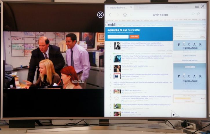

The JS9500’s Multi-Link Screen feature enables a split-screen view where half of the screen can display video from a connected source device while the other half displays an app or web page. It is easy to switch audio sources or control either half without any signs of slowdown.

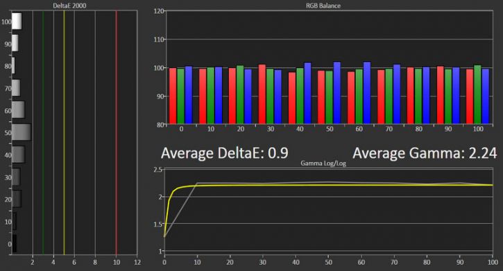

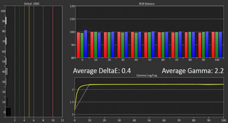

Samsung’s best TVs receive a factory white balance calibration before going into the box, and the JS9500’s Movie picture preset proved well-tuned to deliver an accurate and faithful representation of HD video sources as noted in the default grayscale measurements below.
DeltaE 2000 grayscale errors below 3.0 (green line) in motion video are considered unnoticeable to people with normal vision. The JS9500’s 2- and 10-point white balance controls proved effective at further improving grayscale accuracy as seen in the post-calibration results below.

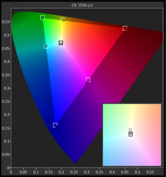

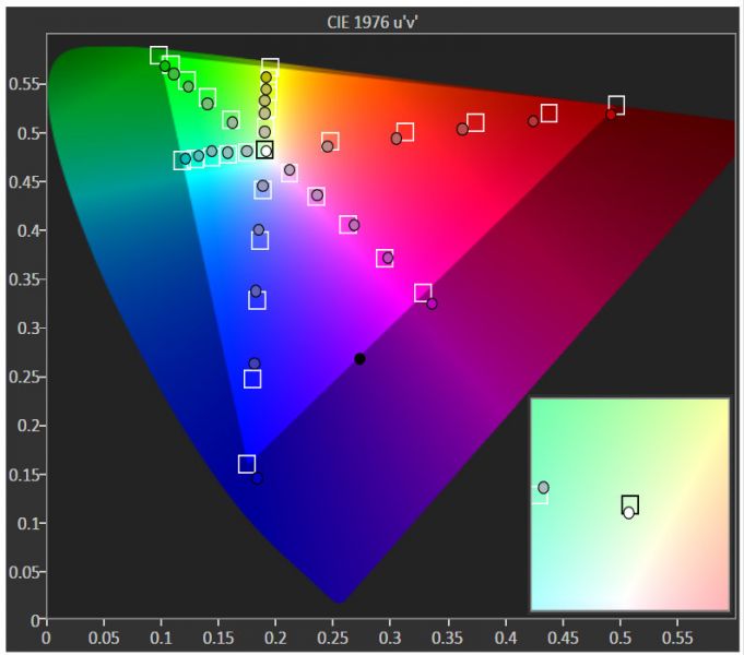

Likewise, the TV’s HD color space coverage exhibited excellent accuracy with primary and secondary hues. The JS9500’s color management system (CMS) was more rudimentary than I’ve seen in competitors’ products, but the end results were satisfactory.
Beyond High Definition Color
The JS9500’s quantum dot-enhanced backlight system enables increased color saturation as well as an extended color gamut compared to regular LED backlighting. With HDR sources that feature expanded color palettes, Samsung recommends using the TV’s automatic color space setting, which negates the use of the CMS controls. After performing a basic white balance calibration with this configuration, DCI (P3) color space coverage and accuracy were quite good as indicated in the chart below.

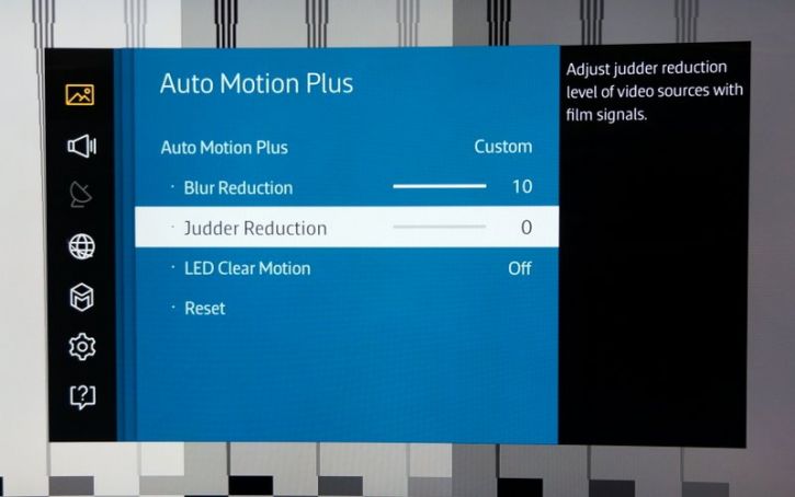

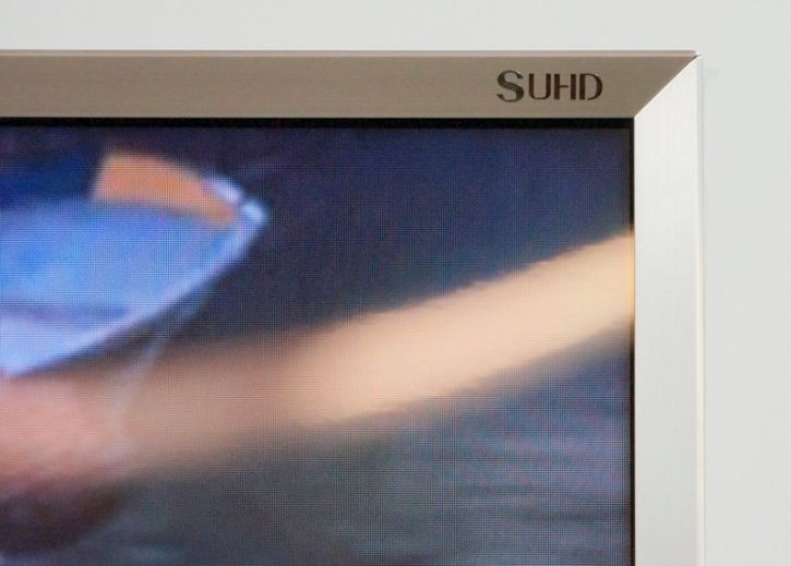

Samsung’s better TVs, including the SUHD models, feature independent controls for enhancing the motion resolution of content captured at 24 and 30/60 frames per second. These independent controls make it easy to avoid the unnatural smoothing of video motion with movies and prime time TV shows (24 fps), a.k.a. “soap opera effect,” while enhancing the clarity of higher frame rate content like sports programming.
The classic FPD Blu-ray benchmark disc proved the JS9500 was able to resolve all 1080 lines of detail compared to the 300-350 lines for all other LCDs that lack motion resolution enhancement or have the feature disabled. I noted a slight hiccup at the 900-line mark in this test that vanished completely when LED Clear Motion (backlight blinking) was enabled. LED Clear Motion’s primary benefit is improved motion resolution with all video content without altering the look of the presentation, but the downside is a reduction in overall brightness and an increase in flicker that some (including myself) may find visually unacceptable.

While purists will likely disable the TV’s de-judder enhancement altogether, I found that increasing it to 1 or 2 (out of 10) slightly tamed the related artifacts without rendering the video unnaturally smooth. Turning the setting up to 6 or 7 drastically improved motion resolution of 24p content but at the expense of faithful reproduction.
