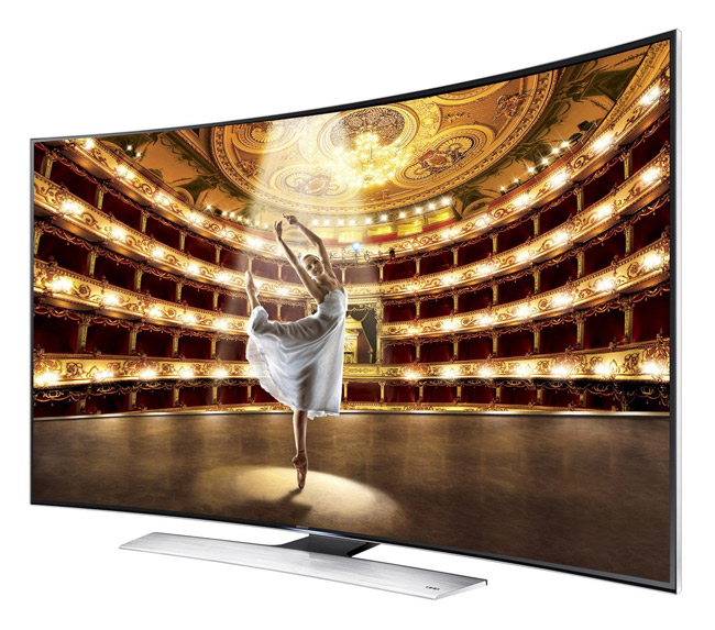

So I was pretty excited to get Samsung’s 65-inch UN65HU9000 LED/LCD UltraHD TV in for review. I was fortunate to also have the closely related (but flat) sibling, the UN65HU8550 in at the same time. Having both allowed me to go deep into both TVs, to note similarities, and just as importantly, any differences. If you’re not interested in the comparison, scroll down a bit to dig into the HU9000’s details.

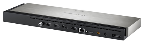

One Connect To Rule Them All
When I first saw the One Connect box, which all source devices are connected to and then a single cable is run to the TV, I thought it was a brilliant idea. While some other recent Samsung TVs have a space reserved on the rear panel for an upgrade kit (Evolution Kit), with the introduction of the One Connect box, all of the critical video processing functions are in there, and if an upgrade or spec change requires it, there’s no need for major surgery to the TV – the One Connect box simply gets replaced.
That happened with some of Samsung’s TVs last year – adding HDCP 2.2 compatibility and HEVC decoding for streaming 4K content. The cost to the customer for the upgraded box was a most reasonable $300 – I have to assume that the upgrade box was priced very close to landed cost, with little to no markup along the way. It’s a nice way of letting customers get the latest features without having to buy a whole new TV.
For the 2014 range, there aren’t any immediate plans in the works for a future One Connect box upgrade, but that the HU9000 has the capability to accept it should give comfort to enthusiasts to know they won’t have to shell out big bucks to swap out the TV if future improvements – even new connection standards – do come down the pike.
3D? Is That Still a Thing?
The HU9000 is a 3D-capable set, and comes with 4 pairs of active shutter 3D glasses with Bluetooth/RF synchronization to the TV. I much prefer active shutter 3D technology, as you get to see the full resolution of the TV, and with none of the objectionable artifacts that accompany passive polarized 3D TV. The glasses are coin-battery powered and therefore not rechargeable, but the batteries they use are cheap and easy to find. They’re also very lightweight, and super comfortable to wear. Samsung claims about 70 hours of use per battery and replacement glasses come with two batteries in the box, for under $20/pair.
We’re All Connected

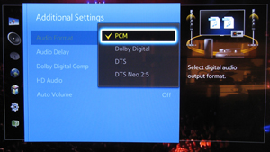

The One Connect box has pretty much all of the connectivity options one would expect these days, including 4 HDMI inputs (1 with Audio Return Channel), a component video input, a composite video input (the component input can double as a second composite input), and the 3 USB ports. An RJ-45 LAN port is provided for wired connection to your network, and the set is equipped with built-in Wi-Fi. There’s an optical digital audio output to connect to an AVR or sound bar system, along with a stereo analog output (Yay!) for connection to an external stereo system.
The antenna jack and a port for the supplied infrared flasher round out the package, and the USB ports are conveniently on the right side of the box for quick connects and disconnects. The box itself is quite compact and lightweight and it easily fits under the TV’s screen parked on top of the sleek TV stand’s base.
For on-wall installation however, that One Connect cable comes with a glaring defect: it’s a rectangular-shaped cube with very sharp points on the corners, and is (I think) sized for style rather than functionality. For in-wall wiring, the National Electrical Code specifies that any holes drilled into wall studs and fireblocks (horizontal 2×4’s placed between the vertical studs) be limited to 1/3 the maximum diameter of the width of the stud.
For a typical 2×4 wall stud or fireblock that typically doesn’t measure 4″ (it’s often closer to 3.5″), that means the installer is limited to drilling a hole that’s only a little over an inch in diameter (about 1.2″). Measured across the diagonal, the connector plugs’ very sharp end points measure out at 1.12″ apart, leaving a scant 10th of an inch or so wiggle room. For a conscientious installer who wants to do a good job and also meet code, that connector is going to present some misery as it won’t be easily “fished” through a tight fireblock hole, possibly necessitating tearing out more drywall than he might otherwise have to (and subsequently having to install larger patches and then re-tape and re-paint, etc.).
The One Connect cable’s length is 3 meters (just under 10 feet), and Samsung does not offer an extension cable (the cable, the TV and the One Connect box use multi-pin connector that I’ve never seen used on a CE device). That 10 foot restriction further adds to possible problems when hanging the TV high up on a wall, and having the source components in an equipment closet further away.

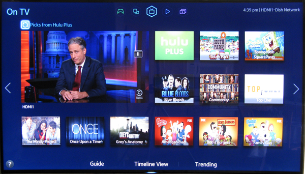

Virtually identical to its flat panel sibling, the HU9000 has a clean, modern on screen design and user interface, with the Smart Hub categories grouped into 5 screens. The main screen has a large TV window along with program suggestions, while the adjacent apps screen has all the content providers, streaming services and such.

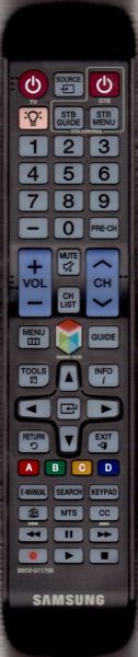

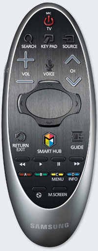

The TV ships with two remotes, an oval remote with a cursor/touchpad and built-in microphone for voice recognition, and a more conventional push-button remote that has a very clean design (it’s also backlit, which is a plus).
I called up the web browser app, and via the voice remote, said “www dot speed test dot net”, and the browser was able to get me to the speed test website so I could test my download speed. I used other similar commands, and the translator got almost all of them right. So while motion-control didn’t do much for me, voice control worked surprisingly well.
For serious web browsing however, I’d recommend getting a wireless Bluetooth keyboard with a built-in mouse pad, which the Samsung can accommodate.

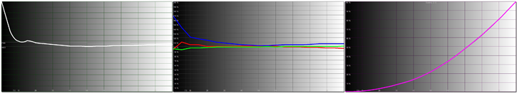

The Analyzer Speaks

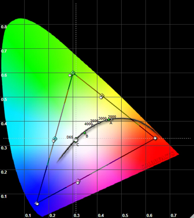

As has been the case with a number of Samsung TVs I’ve tested in recent years, the Movie mode proved to be, by far, the best choice to obtain the best test bench results, and the HU9000 measured very well on all the key metrics.
I was especially keen to run an extensive sweep of color and gray scale test points, as the HU9000 has a 192 point color look up table as an internal reference (that’s more than 7 times as many reference points as the HU8550’s 27 points).
The result, measured in DeltaE (DeltaE, or dE, is a metric for color variance), was excellent, with an average dE of 2.06 – if average dE is 3 or less, that’s an “A” score (especially since this was achieved with the out-of-the-box factory default picture settings).
And with a full calibration it can be made to be even better, if you’re really fussy about fine-tuning the HU9000 to achieve its fullest potential.
