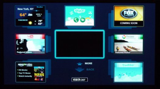

As we’ve written about many times before, Panasonic has been coming on strong with their ever-expanding VIERA Cast suite of built-in internet-based entertainment applications, and the TC-P50G25 is no exception. Already available is YouTube, Netflix, Pandora, Twitter and Picasa Web Albums (Netflix, Pandora and Twitter showed up during the course of my review), with a FOX Sports feed “coming soon” and perhaps other apps and widgets to follow. Skype is in the house today, complete with big-screen two-way video conferencing (requires optional Skype Communication Camera accessory).
The TV’s USB ports are ready to accept optional gear such as Panasonic’s Wireless LAN Adaptor (aka a WiFi USB dongle), or the TY-CC10 Skype Video Camera. We can even plug in a USB keyboard (wired or wireless), which makes surfing YouTube, Picasa or Twitter that much easier. We can also customize the on-screen layout of our VIERA Cast apps, putting our favorites on page 1 while less favorite apps (like that German language news feed…?) get relegated to pages 2 or 3.
Pandora and Netflix, again later arrivals, first appear on Page 2 of the VIERA Cast apps, and we are invited to activate them either with our current account info if we have it, or we can start from scratch. Netflix directs us to netflix.com/Panasonic to begin a free (and awfully seductive) trial, Pandora is even quicker and easier, and the entry-level account will have us rocking TV tunes in practically no time. Picasa is actually a sort of YouTube for still photos, pushing us seemingly random “featured” images with the freedom to search for what interests us. Thank heaven for that keyboard.

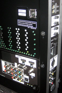

At 3.5 inches, the TC-P50G25 is a bit thicker than many other flat panel displays on the market. While this will not be immediately obvious with the TV standing atop the included swivel stand, its girth might be more noticeable when hung on a wall, using the optional TY-WK4P1RW wall-mounting bracket or any compatible after-market wall mount. Connectivity is ample, with a total of three HDMI ports (2 rear, 1 side) including one which supports the Audio Return Channel, for more hookup versatility. There’s also an SD Card slot on the side, near the jack pack, to feed the VIERA Image Viewer and immediately display our digital photos (and home movies) on the high-def screen, fresh from the camera, with assorted background music and different slide show playback options.
