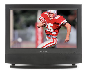

The Syntax-Brillian "Olevia" brand is a common sight in online stores like Amazon, buy.com, and TigerDirect, with prices that leave the larger competitors in the dust. But can they compete with the more established brands in design and picture quality? To find that out, we've put one of their more popular new models, the
Olevia 542i 42-inch LCD flat panel HDTVthrough its paces, and, for the most part, it has fared well, but not without some caveats.

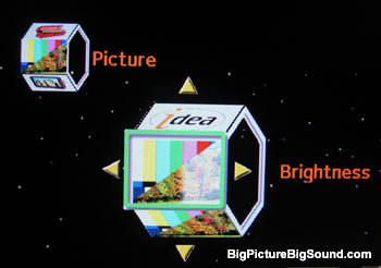

And this brings me to my second point about ergonomics. The Syntax folks describe the GUI OSD (On-Screen Display) menu as "easy to use," but I found it anything but. The menu does include a cool visual effect of a rotating 3-dimensional icon that changes as you scroll through item menus, but I found it very difficult to navigate and to get used to, particularly since there is only one option on the screen at any one time, instead of multiple choices as you'd see in standard menus.
Also, when I went to set-up TV channels using the built-in tuner, it took me a while to figure out that the tuner set-up options only appear on the set-up menu if you have specifically set the TV source to "tuner." It's a context sensitive menu that has different options depending on which input is selected. I've set up quite a number of TVs in my time (for reviews and installations) and I found the Syntax menu to be one of the hardest to learn and get used to. But over time it gets easier.

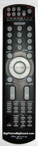

The remote control is a backlit/universal model which allows you to control multiple components in addition to your TV. I like the lit-up indicator that shows you which mode you're in (i.e., which device you're set to control), and the directional menu navigation controls are well laid out. However, many commonly used buttons are too small and uniform to make them easy to use — a function so important as the "aspect" button (to adjust the aspect ratio of screen) is positioned in a bank of other identically sized buttons toward the bottom of the remote.
The remote offers no direct source input buttons. If you want to switch sources (e.g., from tuner to HDMI to component input) you need to click on the "source" button on the remote to cycle through the inputs or click down into the menu and cycle through the inputs there.

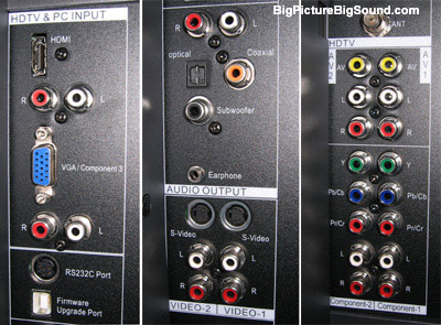

In terms of connectivity, the 542i has all the inputs you'd expect plus one or two you might not. It includes 1 HDMI A/V input (with HDCP), 2 component video, 2 composite, 2 S-video and a VGA port which you can also use (via an adapter) as a third component video input. I'd have liked to see a second HDMI input, but if you have a home theater receiver or external video scaler with HDMI-switching then this will not be necessary. Also included are an RS232 jack (for control system integration) and a USB port to accept firmware upgrades in the comfort of your living room.
For audio connections, the unit features line-level audio outputs and a headphone mini-jack output, plus a subwoofer output in case you'd like to use a powered sub to supplement the bass output of the built-in speakers. The jack-pack features S/PDIF fiber-optic and coax digital audio outputs for the built-in tuner. These allow you to watch TV shows and movies (broadcast or cable) in discrete 5.1-channel surround via an external receiver or surround processor.

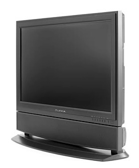

In terms of its aesthetics, the styling of the Olevia TV is actually quite nice for an entry-level HDTV. Our review time with the Syntax overlapped with the similarly priced and similarly feature-laden
Vizio L42, and my wife (the one with the discriminating eye in the family) definitely preferred the design of the Olevia. And if you don't like the speaker placement on the bottom of the unit, you can move them to the sides (with an optional mount) or remove them entirely leaving just a sleek black flat panel, with a fairly thin frame, ready for wall-mounting or in-cabinet installation.

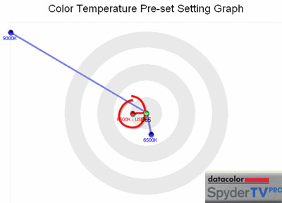

Viewing ImpressionsAs with most of the TVs seen here in the BPBS labs, the Olevia 542i benefited from professional calibration. Although simply setting the lighting to "medium room" and color temperature to "6500" does get you closer to an accurate color balance than we've seen on most televisions, we were able to get the set even closer to 6500° Kelvin after calibration with
SpyderTV Pro. Also calibration removed some of the more obvious digital nasties from the picture as well as minimizing the hot-spotting from the internal lamps.
The Olevia's poor menu design struck again in the picture setting menus – the sliders for picture settings such as color, tint, brightness and sharpness have no labels or identifiers to identify the magnitude of adjustment, only a pointer in the center of the range so you tell where "0" is. In order to work with the Spyder TV Pro calibration software and colorimeter, I had to manually count the number of steps from top to bottom for each one of the different picture settings and be very careful when making adjustments to click the button the precise number of times.

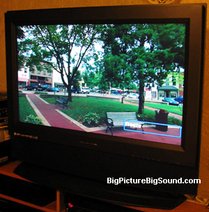

On high definition material, the set really shone, with rich vibrant colors and excellent detail. The picture was sharper and cleaner on 1080i HD-DVD titles ("Unforgiven," "Bourne Supremacy," "Sahara") than on any other source, but the built-in ATSC tuner did a good job presenting HD material on television broadcasts. Contrast was very good for an LCD TV, but blacks and dark colors were not reproduced as well as on a good plasma or CRT TV. The adjustable noise reduction circuitry came in handy to clean up less-than-perfect SD or HD broadcast signals.
