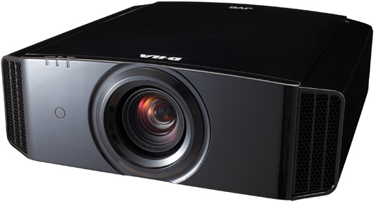

Like JVC’s other projectors, the X3 has a single 220-watt UHP lamp sunning three 0.7-inch, “D-ILA” (Direct-Drive Image Light Amplification) chips. D-ILA is JVC’s proprietary version of LCOS (liquid crystal on silicon) technology, a sort of a hybrid between DLP and LCD. A layer of liquid crystal is on top of a mirrored surface. Light reflects off this mirror only after passing through the LC layer, twice.
The technology offers smaller inter-pixel spacing than LCD, with a higher native contrast ratio than either of the other projection technologies. JVC and Sony use LCOS for most or all of their front projectors. Recently, other large projector manufacturers such as Epson have announced LCOS models, presumably because it can handle 3D better than LCD projection.
Other features shared across the JVC range are +/-80% vertical and +/-34% horizontal lens shift, 2x motorized zoom, two HDMI 1.4a inputs, and one component input. Interestingly, there are no composite or s-video inputs, but honestly, who cares about that? Any decent outboard scaler or home theater receiver can handle conversion of your old analog sources to HDMI. You get RS-232 and a 12v trigger for custom install control.

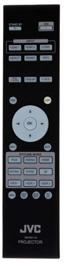

The remote has a pleasant rubberized feel, and has a strong amber backlight. Not that you’ll use it much, but it works well.

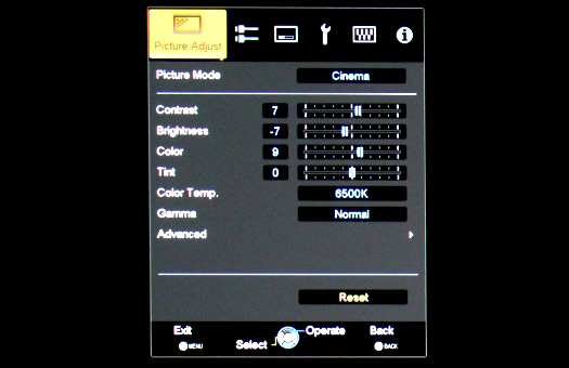

There are a minimal amount of picture adjustments, at least compared to many new projectors. Color temp and gamma have presets and custom adjustability. Color space is limited to Normal, Wide1, and Wide2. It’s certainly all enough to get the job done, but a far cry from what’s available on the step-up X7 (see below).
Unlike most new projectors, the X3 doesn’t have an auto-iris, a device that tracks the incoming video signal and makes dark scenes darker and bright scenes brighter. The simple reason for this is that it doesn’t need it. The native contrast ratio of the LCOS chips is vastly superior to LCD or DLP technologies, so it doesn’t need iris trickery (which never really looks right anyway). What you do get is a multi-step non-tracking iris, and two lamp modes. Honestly, you won’t need those either, as we’ll see.

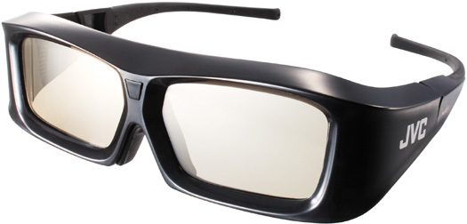

In order to add the depth dimension, you need the PK-EM1 3D sync emitter ($79) and JVC’s active shutter glasses ($179, each). The emitter is slightly larger than a deck of cards, and worked fine for me resting on top of the projector, aimed at the screen.
The light loss through the glasses made even a bright movie like How to Train Your Dragon seem dim and rather lifeless, compared to the best 3D I have seen. Turns out, you need to manually switch to the 3D mode in the user menu. This mode compensates for the glasses, and makes for a much more pleasing image. All the settings will be different, so you’ll need to tweak it to look correct. I used the settings I had picked in the Cinema mode, plus 500-1000 Kelvin in the Color Temp to compensate for the slight yellowish tint of the glasses.
Properly set up, the 3D image is reasonably bright, and on par with other 3D projectors I’ve seen. That is to say, good, but not great. It doesn’t hold a candela foot-Lambert to the Sharp in this regard, one of the few things that projector does well.
