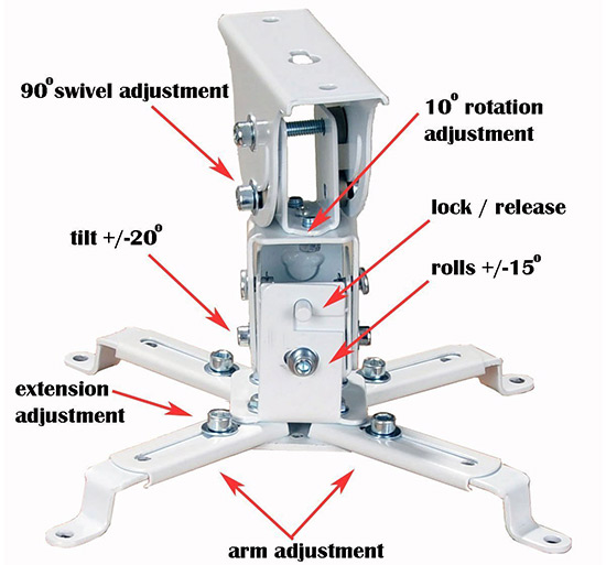

First of all, the PJ2W mount comes with all of the necessary hardware (screws, washers, etc.) and the instructions are actually pretty clear. The only extra tool I needed was a drill for the ceiling mount holes and a Philips head screwdriver to tighten the mounting plate to the projector’s mounting holes. The mount comes with two Allen wrenches to adjust the rest of the various bolts.

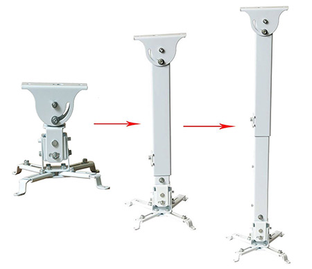

The VideoSecu mount comes with an adjustable extension arm, which you may or may not need. If you want your projector right up against the ceiling, you can mount it without using the extension arm at all, and this will put the top of your projector 5.5″ from the ceiling. For me this was just slightly too high to clear the globe light on my ceiling and create a squared off image on the 92-inch screen which is permanently mounted to the wall.
I decided to try the extension arm, which drops the projector down significantly lower, with a range of around 16.9″ to 25.6″ from the ceiling and this was too low to avoid using keystone. Now I know how Goldilocks felt! At the least amount of extension (16.9″ from ceiling), I was able to square off my projection image using about +7 on the vertical Keystone scale on the projector. This isn’t terrible, and did create a nice-looking image for most content, but putting up a 1080p test pattern showed that the view-able image was no longer getting the full 1920×1080 pixel resolution. In actual viewing, this becomes noticeable mostly with text (like movie credits), and a subtle loss of detail on real world content like movies and TV shows.

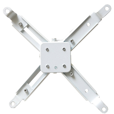

The only other issue I had with the mount was due to the Epson projector having three instead of four mounting holes. The mounting interface has four adjustable feet that screw into holes on the bottom of the projector. Most projectors have four holes but the Epson Home Cinema 2000 and 2030 have three holes. The manual that came with the mount suggests that you remove two of the feet and place one of them in a fifth hole that is located between two of the others on the mounting plate. The problem is that the mount I received has no fifth hole – it’s simply not there. It is pictured on the VideoSecu web site with a fifth hole, so I’m guessing they may have added this hole to a later version of the mount and I may have gotten old stock.
I ended up leaving all four legs on the mount and just used three of them. Using two of the long feet and one short foot reversed (for the projector’s center hole), I was able to get a nice tight mount, pretty close to the projector’s center of gravity so it was not pulling in any one direction. If you have a larger projector where the mounting holes are further apart, you may need VideoSecu’s W53 extension adapter which is available online. With the extended legs, the maxium extension of the mounting legs is 17 inches (vs. 12.5 inches with the standard length legs).
