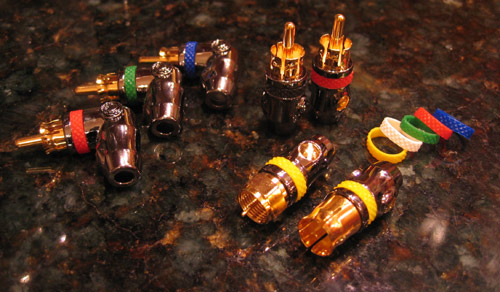

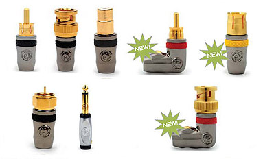

Planet Waves "HD Series" connectors all feature 24-carat gold plated contacts and a sleek black chrome finish. All of the connectors we tested felt heavy and solid in the hands with a smooth and stylish fit and finish. These are high-end connectors, without a doubt. The available flavors of connectors include RCA type (straight and right angle) for composite video, component video, analog and digital audio use, F-type connectors for cable/antenna/satellite feeds (both screw-on and leaf-spring push-on types), BNC connectors (straight and right angle) as well as 1/4-inch male connectors, Because S-video requires four conductors, Planet Waves also offers an RCA to S-video Y-adapter that uses two length of RCA-terminated cable to carry the S-video signal.
Planet Waves also includes an assortment of color-coded rubber rings (white, black, red, orange, green, yellow, blue) with each pack of connectors. These sit nicely on the connectors in order to label them for each specific use. D'Addario recently introduced a more affordable "Ni" series of connectors featuring nickel-plated terminations which should offer similar performance for a lower cost.

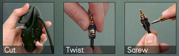

Tools of the TradeAlthough the Planet Waves cables require no soldering, stripping or crimping, they do require cutting, and a clean cut is important. The cable comes with a basic razor-blade cable cutter with a hole to slide the cable in for cutting. It's also a good idea to test the cable after assembly – to ensure you've got a solid clean connection for both the conductor and the shield. To this end, Planet Waves also offers cable testers which can be used to verify the mechanical connection of the connectors. Simply insert the connectors into the tester's jacks and press two buttons (one for ground, one for tip). If the lights turns green, then you're good to go, if the light doesn't illuminate or the red "short" light glows, then the connection is bad and you'll need to re-do the assembly.
Planet Waves also offers a combined cutter/tester that is handy for the custom installer who wants to carry around as few tools as possible. The only other tool you'll need is a small flat-head screwdriver, which you'll use to screw in the set screw that attaches the connector to the cable. That's it.
The Assembly ProcessI had both the single-strand coax cable and triple-strand cable on-hand for testing. I opted to use the triple-strand cable to create a 20-inch long component video cable. The only slightly confusing part of the assembly was figuring out how to cut the length of triple cable from the spool. The cable cutters cut individual cable strands but they do not accommodate the width of a triple cable bundle. I opted to use a heavy-duty pair of Fiskar scissors to cut the cable from the spool, then used the Planet Waves razor cable cutter to neatly trim each individual cable on both ends. Apparently D'Addario is also aware of this issue, as they have just introduced a new triple-cable cutter as well.
Assembly went something like this:
- Cut each cable
- Twist the connector onto the cable until it would not go any higher
- Screw the set screw, securing the connector onto the cable.
That was pretty much it. About 15 minutes after I had taken the cable spool and connectors out of their packages, I had a length of component video cable, neatly labeled with red, green and blue rubber rings.
