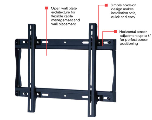

But those who spend $500-$600 on a TV certainly don’t want to spend another $100 or more on a mounting bracket to hang it on the wall. And now they don’t have to, with the Peerless SF640 Universal Flat Wall Mount for 23″ to 46″ Flat Panel Televisions. Is it the most advanced, most feature-rich wall mount television bracket on the planet? No. But it will allow you to put your flat panel TV on the wall, and isn’t that the point?
For a list price of about $70, and a street price below $40, I wasn’t expecting a very elaborate mounting solution. And the SF640 is pretty basic: no articulated arm, no tilt – just your basic mounting bracket. But what surprised me was the ease of installation and the comprehensive selection of mounting screws and bolts that came with the kit. The included English and metric screws of multiple shapes and sizes will accommodate virtually any make and model television of an appropriate size. Sure enough, this “Sorted-For-Youâ„¢” fastener pack included the metric bolts necessary to attach the mounting plates to the afore-mentioned VIZIO VP322 32-inch Plasma Television, as well as some nice beefy wood screws to attach the wall-plate to the studs behind a plaster and lathe wall where we installed it.
Although the mounting bracket is said to work with TVs from 23 inches up to 46 inches diagonally, you should check your TV’s documentation (or check directly with the manufacturer) to determine whether this mounting bracket is compatible with your TV. The mount supports TVs with “mounting patterns” up to 17.73″ wide and 12.94″ high. In English this means that the mounting bolt holes in the back of your television can be no more than 17.73 inches apart (width) and no more than 12.94 inches apart (height). If your TV’s mounting pattern is larger than this in either dimension then look elsewhere for a mounting bracket. The load capacity of the mount is up to 150 pounds so this should accommodate most flat panel TVs 46 inches or below (assuming you mount it properly).

If you’re looking for a simple but effective wall-mount for a small to medium size flat panel LCD or plasma television, the Peerless SF640 is an excellent choice. Its comprehensive mounting hardware, simple instructions and low price leave little room for improvement.

- Universal mount fits screens with mounting patterns up to 17.73″ W x 12.94″ H
- Open wall plate architecture allows for total wall access, increasing electrical access and cable management options
- Ultra-slim design holds screen only 1.2″ from the wall for a low-profile application
- Horizontal screen adjustment of up to 6″ (depending on screen model) for perfect screen placement
- Universal brackets easily hook onto wall plate for fast installation
- Mounts to wood studs, concrete, cinder block or metal studs (metal stud accessory required)
