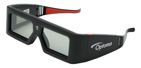

To get the 3D feature to work, you will also need one or more sets of active 3D glasses — specifically “DLP-Link” glasses — which allow you to get a 3D image from compatible DLP projectors. We opted to use Optoma’s own DLP Link glasses (model BG-ZD101) which are battery-operated, rather bulky but comfortable enough, and come with 3 nose pieces so you have a few options as to fit. We inserted a Blu-ray 3D disc into the player, powered up a pair of glasses and sat back to enjoy the ride.
