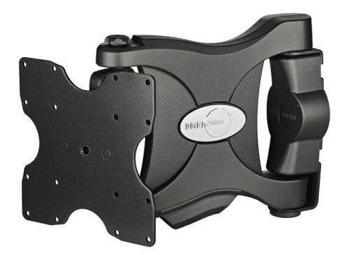

Fortunately, it’s no longer necessary to bust junior’s piggy bank to pay for that coveted corner mount. OmniMount’s 4N1-M WorldMount Series flat panel wall mount is a – yes – articulating mount (i.e. it has a hinge or pivot connection enabling a wide range of motion), and it doesn’t take a rocket scientist, or even a person with an advanced degree in carpentry, to put it on the wall. The 4N1-M allows you to mount your TV in a corner and still have the ability to turn it in different directions to face your current viewing angle. And the 4N1-M offers this maneuverability and ease of installation at a fairly affordable price (the MSRP is $149.95, but we found it on Amazon for much less).
Is it perfect? No. The 4N1-M’s mount arm is sheathed in a somewhat bulky-looking plastic housing that creaks a bit when the mount arm is moved, and it comes with overly long (at least for our purposes) lag bolts. But these are relatively minor faults which don’t affect the 4N1-M’s essential characteristic: it is an extremely good value. But I’m getting ahead of myself…

With the mounting bracket securely in place, completing step four seemed a simple matter of fitting the mount arm into the holes on the mounting bracket, then hand tightening an adjustment screw on the bracket’s lower end. We did that, only to have the mount arm screech, pop and creak like a braking subway train as soon as we moved it. Figuring we may not have seated the arm properly, we pulled it off and tried again. This time it dropped nicely into place, and — Shazam! — the creaking and popping disappeared — well, for the most part (see below). Once installed, the mount tilts, swivels and rotates with ease; the adjustments carried out by loosening and tightening strategically placed, easily accessible Allen screws and/or conventional nuts.
In terms of design, OmniMount’s higher-priced — ahem — articulating mounts embody a modern, minimalist aesthetic, their metallic arms narrow and unadorned. The 4N1-M’s metal frame, by contrast, is covered by a plastic housing which gives the mount a slightly bulkier appearance in comparison to its cousins. This housing boasts several handy features — notably an underside compartment for facilitating cable management and a built-in Allen wrench holder. It also tends to creak ever so slightly when the mount arm is moved back and forth, probably due to friction between the housing and the metal arm underneath. Happily, this is no reflection upon the 4N1-M’s solidity. When properly installed, the 4N1-M is not only rock-solid, but also conveniently vanishes behind the body of the TV, rendering any quibbles as to its aesthetic drawbacks essentially moot.

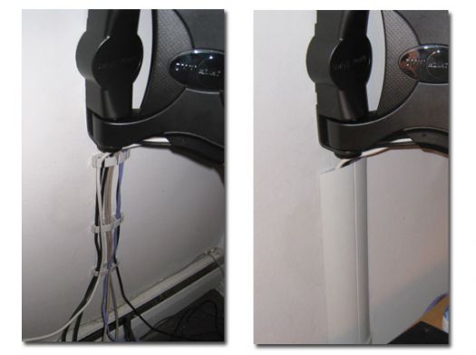

Okay, so the 4N1-M isn’t quite the Porsche of articulating mounts, but nor is it priced as such. Nevertheless, distinct measures can be taken to improve its overall appearance, like deploying a decent cable management system. As we’ve seen, the 4N1-M makes an initial stab at addressing this problem via a convenient cable routing attachment on the underside of its plastic housing. Unfortunately, this imposition of order only lasts about two inches, then the cables reemerge at the back of the mount and wire clutter again reigns supreme. The best way to hide cables is to really hide them – tucking the cables neatly away inside the wall. But did I mention the landlady? Getting her to agree to let us put two screws into the wall to hold the TV was tricky enough. Carving out a large enough hole in the wall to run cables through it might have sent her to the hospital.
Enter OmniMount’s CMK (cable management kit). Essentially consisting of a several cable clips attached to the wall at regular intervals, then topped by a series of plastic covers, this easy-to-install optional cable management system obviates the need to run cable through gigantic holes in the wall. As with the 4N1-M, the CMK includes an illustrated installation guide intended to be simple enough for even a DIY-challenged octogenarian to understand. And as it happened, we two paunchy, slightly inebriated forty-somethings couldn’t make head nor tail out of it.
Incomprehensible directions notwithstanding, the installation is actually quite simple: (1) choose a cable pathway on the wall; (2) attach the clips to the wall using either adhesive strips or screws (both supplied); (3) route the cables through the clips; and finally (4) snap on the cable covers. Presto – bye bye wires! The entire install took 15 minutes tops, and the results were plain to see – except for the wires, that is. In short, the CMK makes for a practical and aesthetically pleasing complement to the 4N1-M when going in-wall simply isn’t an option.
