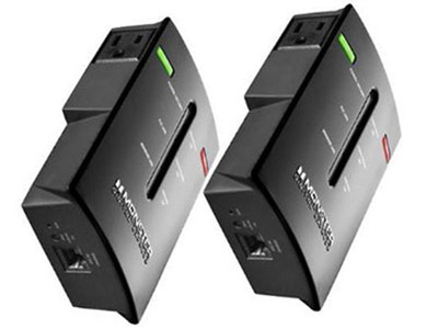

The Powernet 200 adapter is designed to completely cover a standard two-plug AC switchplate, taking over the entire thing, but in return it gives us a pair of filtered outlets, the noise-reduction benefits of which can come in handy when connecting sensitive high-definition video equipment. These outlets are turned 90 degrees to the left and right instead of pointing straight outward, for a lower profile that allows us to push furniture right up against it if need be. However, this can be tricky as now the outlets are flush up against the wall, so certain oversized or angled plugs (including that on a Monster power strip I’d been using) might not fit.
Next we run an Ethernet cable (included) from the router to the source PowerNet 200 module. Then another cable from the destination PowerNet 200 device to the Blu-ray player, TV, etc, and most likely, we’re done. How can we tell? The devices feature an elaborate system of indicator lights on their face. I think it’s fair to say that the most relevant information (Power/Security, Network Speed and Ethernet Link) are all on the left side, while the “bonuses” (Protection On, Clean Power On, Ground OK) are on the right.
