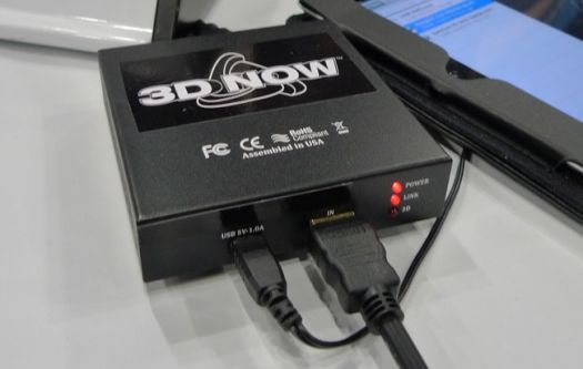

The 3D Now converter box is positioned as a “revolutionary technology” that “converts any 2D HD display – old or new – to a stunning 1080p 3D experience.” What does it actually do? The 3D Now “Theater” converter box takes the HDMI output of a 3D source component, such as a Blu-ray 3D player or 3D-capable set-top box, and converts it into a frame sequential 3D signal at 60 Hz (60 frames per second), alternating the left and right eye signal in the output.
Because the output signal is standard 1080p/60, it is compatible with many (but not all) pre-3D HDTVs. A separate emitter then synchronizes this 3D signal to a pair of compatible 3D glasses so that your brain can see the image in 3D.

The demos that the 3D Now folks had set up at CEDIA suffered from all of the above problems: major flicker, motion distortion (jitter and judder) and crosstalk. Also, on a 60 Hz LG plasma they used for a demo, colors were inaccurate and washed out. Was there a sense of depth to the 3D image? Absolutely. The 3D Now box did seem to deliver on at least part of its promise. But it was definitely not a high quality or enjoyable 3D experience.
