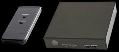

Mitsubishi finally made good on their 3D promise last month by shipping the 3DA-1 3D adapter. This set-top box converts the new 3D source components to the checkerboard output required by Mitsubishi’s 3D-ready DLP TVs. But despite early speculation, these Mitsubishi boxes do not support Samsung DLP TVs. This has kept Samsung DLP TV owners from taking part in the new 3D revolution, with a flurry of new 3D source components such as Blu-ray 3D, FIOS, or DIRECTV set-top boxes. But now it looks like a work around has been found, as Tru3D has released a new kit that will bring Samsung DLP TV viewers into the next dimension.
The Tru3D 3D TV Adapter KIT (MSRP: $319.99) includes the aforementioned Mitsubishi 3DA-1 adapter plus an additional component that Tru3D calls the “HDMI tool” — this is effectively an EDID “spoofer” which allows viewers to use the Mitsubishi 3D converter with a Samsung TV. The key to this technology is the HDMI tool itself which, according to reports, fools the Mitsubishi converter box into thinking that it is connected to a Mitsubishi TV by replicating the Mitsubishi’s EDID (Extended Display Identification Data) codes over an HDMI connection. From here, the rest is easy as Mitsubishi’s line of 3D DLP HDTVs utilize the same “checkerboard” 3D input format as Samsung’s DLP models.
