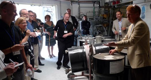

Stewart screens begin life as a powdery resin which is combined with a flame retardant solvent and mixed into a viscous liquid that has the consistency of maple syrup. Pigments and rare earth elements are added in order to come up with the specific Stewart screen formulations such as the popular StudioTek 130, the Silver 3D formulation, and the new StudioTek 100 — a pure matte white unity gain screen. This last one is a new screen formulation that Stewart execs say is ideal for the latest crop of high-end ultra-accurate projectors used in a dedicated home theater environment where excessive ambient lighting is not a factor.

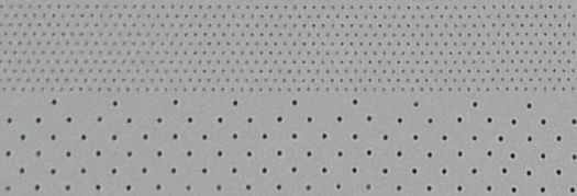

For those individuals and theater owners who want their speakers elegantly tucked away behind the screen, Stewart offers perforated screens which allow sound to pass through transparently while still reflecting light back to produce an image. The Cinema Perforator (CinemaPerf) machine is used for screens 14 feet or taller in height while the Micro Perforator (MicroPerf) machine is used for screens below 14 feet in height.

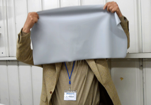

In order to prevent moiré patterns from appearing on the screen, Stewart measures each new projector that comes on the market, so they can determine an ideal skew pattern for the perforations. Stewart then cuts the screen at an angle to meet the optimal skew pattern for the specific projector. Using a swatch of CinemaPerf’ed screen material, Don Stewart demonstrated that we could hear his voice clearly and naturally through the perforated screen.
The CinemaPerf machine punches 6,000 holes per square foot while the MicroPerf machine punches a whopping 30,000 hole per square foot. Even with all these holes, the screen is perfectly capable of reflecting light back to the viewer, as about 90% of the screen material is still intact after the holes are punched. The MicroPerf machine is so precise with tolerances so fine that it requires service approximately every six months, replacing each of the 7,500 tiny pins and recalibrating the machine at a cost of over $100,000.

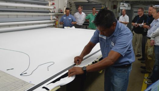

In another room in the sprawling Stewart complex, raw pieces of screen are finished into motorized or manually drawn roll-up screens. I watched in amazement as three seasoned Stewart employees (with nearly 60 years of combined experience with the company) carefully measured, taped and hand-cut the screen materials into a finished screen. In an orchestrated ballet of complementary actions, the three workers positioned industrial strength double-sided tape, weights, micro-tabs, and cord to lower and raise the screen from the mount. One cut the screen edges precisely with a pair of scissors, while another affixed the weighted end to the screen bottom and the other affixed the tabs and tied off the cords. And all this took just a few short minutes.

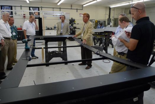

Stewart’s innovative approach to manufacturing extends beyond the screens and into the screen housings. For the massive screen housings which need to be suspended far above audiences and performing artists, Stewart has two rules: make ’em strong and make ’em light. To this end, they use aluminum bracing and frame materials with stiff foam core panels in between. While foam core may be more expensive, it’s less than a tenth the weight of the MDF used by their competitors. Don Stewart demonstrated the effect of this by single-handedly lifting a 25-foot long, 6-inch square screen housing. This lightweight design makes it less likely that the customer will need to add structural reinforcement to their building, just to accommodate the screen. It also helps make things safer for those below.

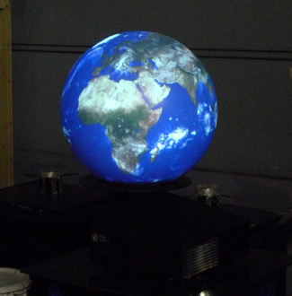

Also, in a demonstration that screens come in literally all shapes and sizes, Stewart showed their fabrication line for a series of projection globes of various diameters. Clear glass globes were being slowly rotatated in all directions via an automated rotation tool. Inside liquid screen material deposited itself on the globe’s interior, until it reached its desired thickness. A projected image is then thrown inside the globe using a projector with a fisheye lens.
Stewart had a finished version of one of these on active display, part of a large order for the Chinese education market where the globes will be used for (among other things), global maps. While one might imagine it would be simpler and cheaper to use printed metal globes for this purpose, when you think about how often the borders and country names on the planet are changing, maybe it makes sense to update these in mapping software which is then projected into this “virtual globe,” rather than scrap a printed metal globe entirely to print an updated version.
