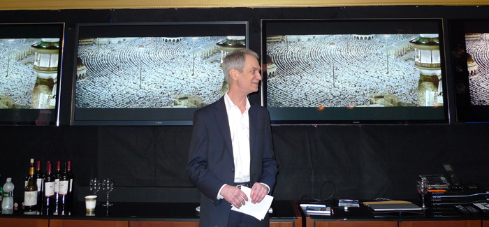

Each year for the past nine years, Robert Zohn, owner of Value Electronics in Scarsdale, NY, has put the year’s top-performing flat panel televisions on display, side by side, in an effort to determine the best TV of the year. It’s called the Flat Panel Shootout and it’s a cool way to geek out on the latest display technology and really compare the top performers head to head. I attended day one of the shootout earlier this month and, even though I’ve seen most of these sets up close before (and have one of them in the labs for review), I was able to learn a thing or two about these TVs.
It’s important to note that Robert doesn’t just plug the TVs in, put on a movie and say, “What do you think?” He brings in talented TV calibrators to wring every ounce of performance out of these sets so each can look its best. This year’s calibrators included Dewayne “D-Nice” Davis, David Mackenzie of HDTV Test in the UK, and Kevin Miller, one of the co-founders of the Imaging Science Foundation (ISF) and a Level II ISF calibration instructor. As with previous years, the content we viewed included test patterns and clips as well as movie clips.

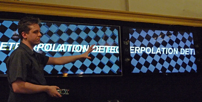

All of the sets looked good on actual movie content, though there were clear performance differences among them. These differences became clearer when viewing test patterns and test clips. We looked at zone plates, grey scale bars, color bars, motion resolution tests and much more, over the course of a few hours on a warm spring night.

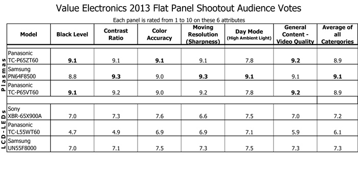

Along the way, attendees recorded their preferences in the form of scores (1-10) for the various elements that make a good picture: black level, contrast ratio, color accuracy, moving picture resolution, and overall picture quality. This year a new category was added for “Day mode” – the ability for the TV to produce a pleasing image in a bright room. One might think this would have given the LED-lit LCD sets an advantage to to their higher brightness, but the actual results were a bit surprising.

In terms of who “won” the competition, based on the popular votes, the Samsung F8500 plasma eked out a win over the Panasonic plasma sets and trounced the LED/LCD competition. Attendees noted its bright whites, excellent color saturation and overall dynamic picture quality.

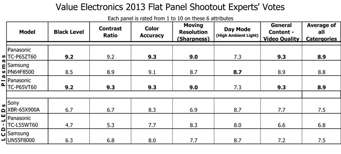

If you look only at the Expert votes (including the calibrators), first and second place were reversed with the Panasonic sets tied for first and the Samsung plasma taking second place.
