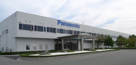

On a recent trip to Japan for CEATEC 2008, I was able to take a short side trip to Osaka (well, short trip on the Shinkansen bullet train, which currently travels at over 180 miles per hour, but I digress). On this side trip I was fortunate enough to visit the Panasonic Eco Technology Center (PETEC) in Kato City (Hyogo Prefecture). The purpose of the PETEC plant is to collect and recycle consumer electronics and appliances that have reached the end of their useful life.

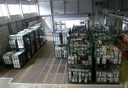

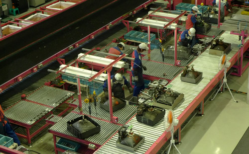

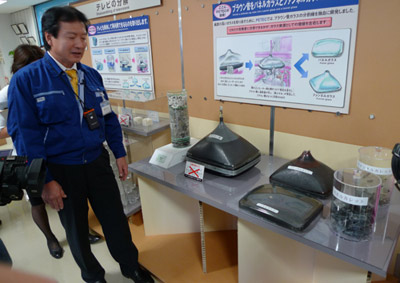

At PETEC, a loading area features endless stacks of pallets, each piled with broken down old appliances awaiting the process that will give them new life as components of new appliances. Specialized assembly lines have trained workers peeling apart the various pieces of these appliances: the copper cooling tubes in an air conditioner, the cast iron compressor of a refrigerator, the leaded glass tube of a CRT TV, the mostly copper wiring harnesses inside a washing machine. These parts are then separated and sorted so that like materials can be grouped together.
