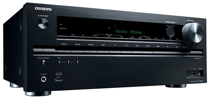

According to a communication from Onkyo this morning, the Onkyo TX-NR636 ($699), TX-NR737 ($949) and TX-NR838 ($1,299) will each get access to the firmware update that delivers Dolby Atmos decoding to these receivers today. Those who have their receivers connected to the internet should get a notice about the firmware availability.
Onkyo recommends using a hard-wired ethernet connection for the update as the file size is fairly large. The update procedure itself can take up to an hour to complete. Onkyo recommends disabling HDMI control (HDCP, or “RIHD” by Onkyo’s nomenclature) during the update. You can also simply disconnect any HDMI-connected devices during the update and plug them back in after the update has completed.
If you’ve chosen not to connect your receiver to the internet, you can still get the update on the Onkyo web site. In this case, you would download the firmware update to a USB thumb drive, insert this drive onto the USB port on your receiver and follow the on-screen instructions. An Onkyo rep told us the update should be live on the site this morning.
