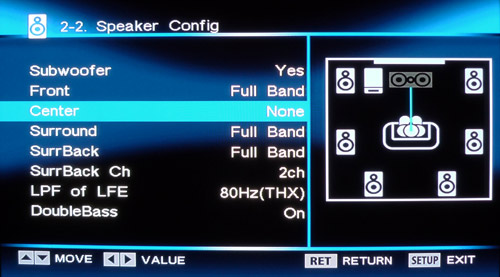

Diane’s main complaint with the system after the Geek’s visit was that she couldn’t enjoy any DVD movies because the dialog seemed to be missing or so low in the mix that it was inaudible over any background music. It turns out that the Geek had turned on the center channel output in Diane’s surround sound receiver, without any center channel speaker connected.
Diane’s system consists of two front speakers (with subs) and two rear speakers. You could call it a “4.0” surround sound (or 4.2 if you count the subwoofers). Because her two front speakers are fairly close to each other, a center channel speaker is not really necessary. Most receivers that support Dolby Digital surround have an option for a “Phantom Center” – this routes all center channel information (mostly dialog) to the front left and right speaker as dual mono, creating a “phantom image” – a virtual center channel that comes from a point between the two main front speakers. To engage this feature, all you need to do is set Center Speaker to “No” or “Off” in the receiver’s set-up menu. If you don’t do this and you have no center channel speaker connected then all that nice juicy dialog disappears into nowhere-land.
Solution? I turned center channel to “OFF” in the receiver’s set-up menu. Hey, listen – there’s a voiceover here!

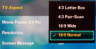

Have you ever been in a sports bar, looking up at the wall o flat screen TVs and everyone looks a little pudgy? Even the supermodels on those Victoria’s Secret commercials? This usually occurs when you take non-widescreen source material (e.g., standard def TV) and stretch it out to fit the whole screen of a widescreen TV. It can also happen when your DVD player or cable box is set to the wrong “aspect ratio” or “TV shape.” And that’s exactly what our favorite Geek did with Diane’s system – he set the cable box to “stretch” mode and the DVD player to “4:3” (non-widescreen).
If a DVD player is set up for a non-widescreen TV (4:3 aspect ratio) but you actually have a widescreen HDTV (16:9 aspect ratio), then the TV will automatically stretch everything out to fit the full screen width, but there will still be large black bars at the top and bottom of the screen on most movies. Now of course, black bars are inevitable on some DVDs and Blu-ray Discs – it’s the only way to fit the whole picture of an ultra wide Cinemascope-style movie (2.35:1 aspect ratio) onto an HDTV screen (1.78:1). But if your DVD player or other source is set incorrectly, then these black bars will be larger than they should be and everything will be stretched out.
Solution? I set the cable box to “normal” screen size (instead of “stretch”) and set the DVD player’s output to 16:9 instead of 4:3. Voila – no more stretching. But damn, that Lindsay Lohan really does need to eat a burger once in a while.
